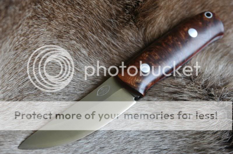

Maybe build your own EnZo scandi with a kit from Bensbackwoods or thompsonsknives. Pure scandi-ground-to-zero O-1 blades.
Here's a curly birch and green micarta....both kits (though I added the lanyard tube to the grn mcrta)

Those EnZo scandi are really nice knives.
Do you need anything special to put together one of those enzo kits? (tools wise) Looks like something I'd be game to try.

BananaClip, that's a curly birch kit from Bensbackwoods, I think is where I got it. I like it too, but I've since gone to putting my own scales on for 3 reasons:
- a wider choice of scale material;
- I can extend the scale (make it longer) toward the ricasso;
- I can put a lanyard tube in the scales.
You can put a lanyard tube in the scales with the Kits, but it's tougher because the Kit scales are already formed and not coplanar.
MarineAir, to put together a "Kit", all you need is some quality epoxy, a couple of three small C-clamps, a grinder (for bringing the Corby bolts down once they're in and the glue has dried), and access to a drum sander with varying grades of sandpaper (about 120 through 320 or 400).
A flexible shaft drill (like a Foredom, Vigor, or Dremel) with a cutoff wheel is nice so you can cut as much excess off the Corbys before grinding is nice. In fact, once excess is off, you can file them flat to the scales with a single-cut bastard file too - the pins are brass and hence relatively soft.
To order just the blades and make your own scales demands a drill press (with drum sanders) and a 1" belt sander, to avoid too much painstaking labor.
I have a Word document set of instructions on how to make your own if you're interested.
