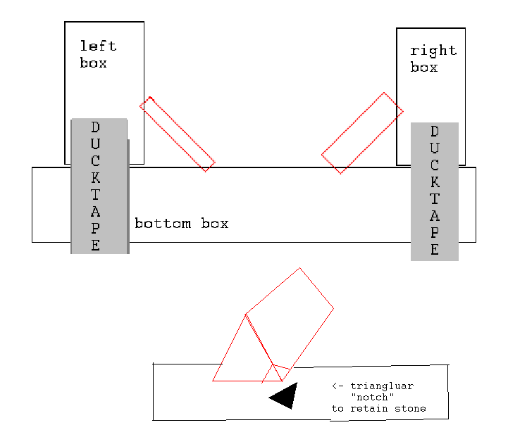

Hi,
update: you can also make a new holder for your sharpmaker stones from three cardboard boxes and some glue/ducktape , just glue two vertically like goal posts, then poke a hole (a notch, a triangle) in the upright and the bottom box so the stones stay put
Not sure I am picturing what you are describing. Can you post up a pic?
Instead of leaning one stones against a wall,
to maintain the sharpmaker way of stones side by side,
just glue/tape some cardboard/boxes together, then lean the rods at the angle you want, then poke a hole/triangle notch top/botton so they dont move around
like a craft project instead of woodshop :)
