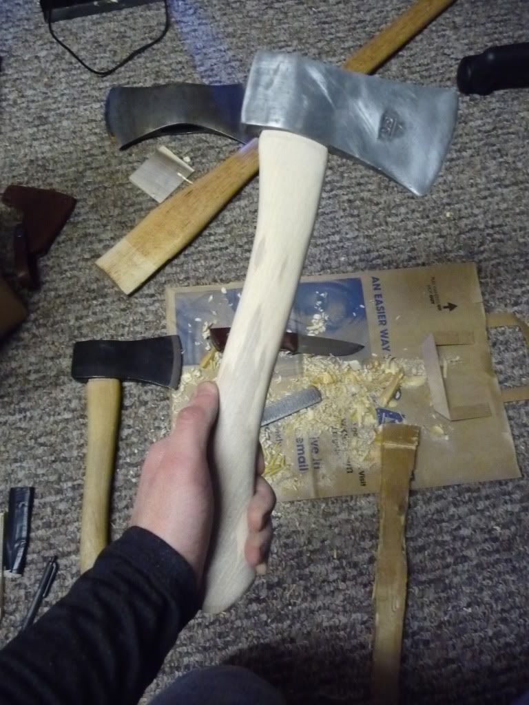

For a camping hatchet, I think your best bet would be to find a vintage hatchet at a flea market or garage sale (or that auction site as a last resort), and fix it up.
Here's one example, with Before and After photos:
from http://www.bladeforums.com/forums/showthread.php/802951-Project-First-axe-restoration

Some of the good brands are Plumb, Collins, True Temper, Norland and others, but if you pay close attention there are many no name hatchets that were made by the folks listed and sold to hardware stores as house brands. The store would just place their own paper label on these sterile hatchets.
Look for signs of hard use and abuse and avoid a head with things like heavily mushroomed polls, cracks, chips, grinder marks on the edge, and heavily rounded heel and toe.
Minor nicks dings and rust is generally not a problem.
