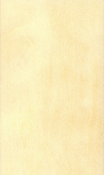

In terms of just color: Hard Maple, Spruce, American Holly. Workability will vary of course; e.g., Hard Maple is far more dense than Spruce, and because of that it tends to be a more stable wood on its own.

For wood, aspen is about the lightest colored stuff that comes to mind. Very light and 'fluffy' so wouldn't make a good functional tool handle, but maybe OK for practice?
