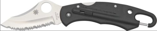

You mean like this?

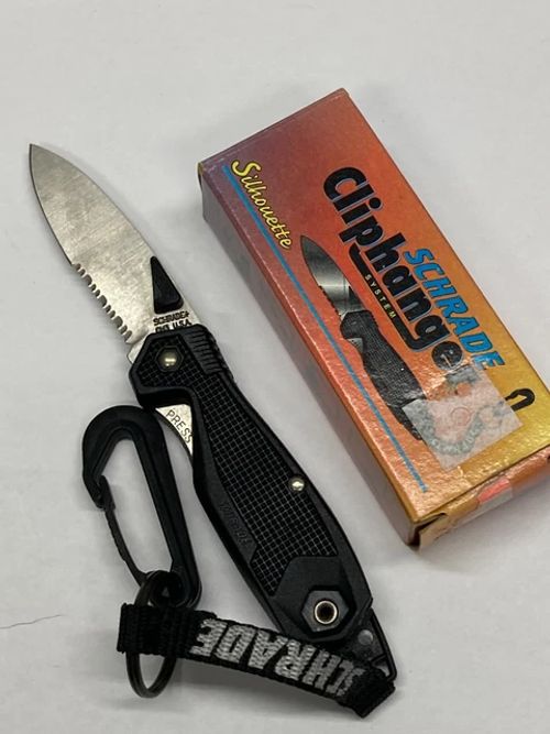

Are you thinking a hidden carabiner like this old Leatherman design?

I've tried a number of different knives that had carabiners thinking I could attach them to a safety harness worn for industrial construction.
The clips were either too small or they were cheaply made.
The spring clips usually bent or broke.
None proved worth owning.
Attaching carabiners to knives has only ever seemed gimmicky to me.. and potentially super unsafe in the "worst case" scenarios. I'd be especially hesitant to carry any frame/liner locking knife attached to myself (or pack, or keyring, etc.) in such a way. I'd be more comfortable with something like the Spyderco Snap-It (shown above) and the closing bias afforded by a back lock, but still.. not my favorite idea..
