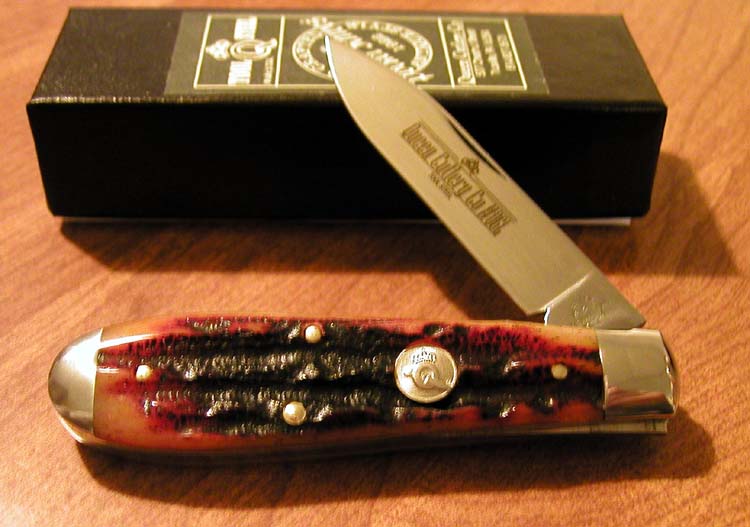

Have you seen these Queen Amber Carved Stag Bone Teardrop Locking Single Blade knives?
Their D2, but they are sort of a single blade Barlow.
THis picture is from the site of the good folks at www.soonerstateknives.com
It's 420HC at about 55RC, which will take an edge quickly, but lose it just as fast.
