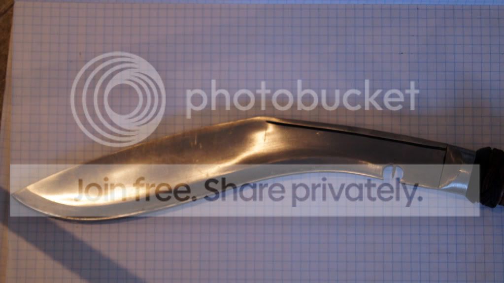

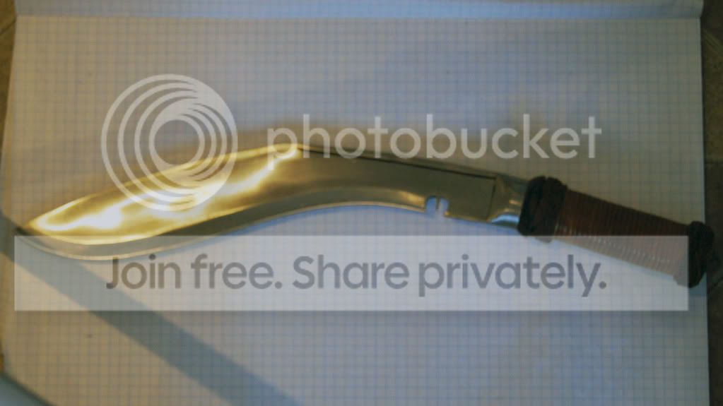

Patrice I have this Khukuri
While not a traditional one and the leather wrapped handle is my own doing I would be glad to send it to you if you wanted to play with it and study it first hand for a bit. I admit that I have abused it a bit and the blade isn't exactly straight any more, but it is still one of my favorite knives and my favorite blade style. If you are interested just send me an PM or email and I could ship it out in 2 weeks.
It is a larger knife with a 12" blade and heavy at just shy of 2 pounds, almost 3 wit sheath:o
Thanks I appreciate the offer Unki but the pic and description should do the trick. That's about the size I am shooting for.

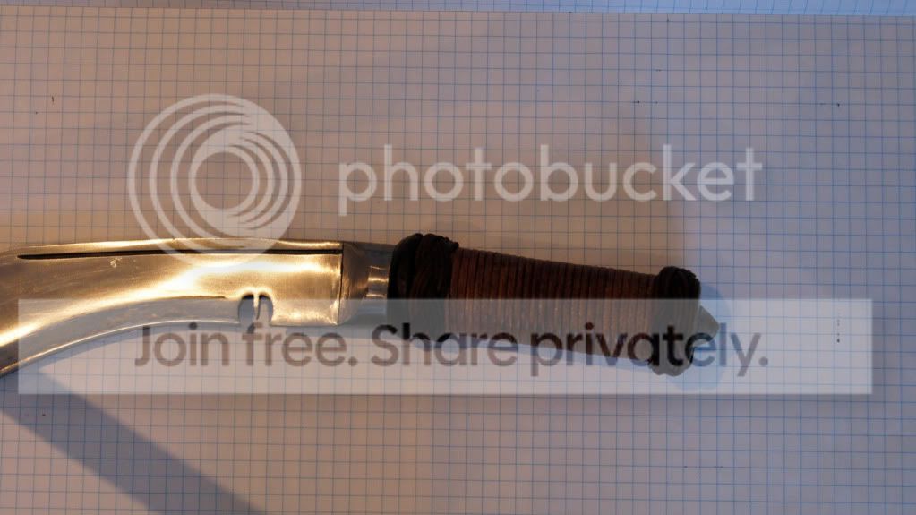

I will take a bunch of measurements today of mine and post them up some time today for you. One thing I will mention is that you may want to make the handle a little bigger, that is one of the reasons I leather wrapped my handle. I found that mine was causing all sorts of hot spots and the front and back of my hand, and I don't have large hands by any means.

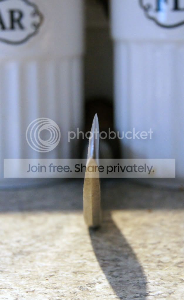

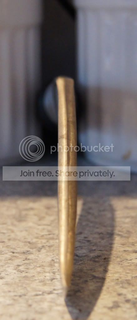

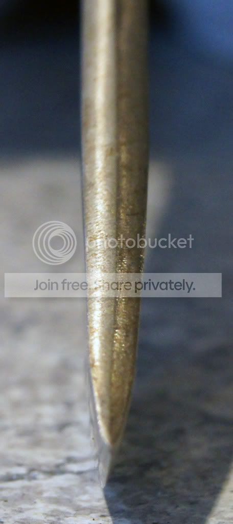

OK here are the measurements from my Khuk
  • overal length: 16.75"
  • blade from handle to tip: 12.5"
  • blade hight at handle: 1.375"
  • blade hight at at widest point: 2"
  • length of drop: 7.25" measured from top side
  • length of flat before drop: 5" measured from top side
  • length of furrel: .75"
  • length of handle, butt to furrel: 4.5"
  • thickness of spine from handle to the start of the drop: 7/16" constent
  • thickness tapers off from drop to point from 7/16" to 1/4"
  • blade has a slight bevel down to the convex edge that starts 1/2" up from the edge
and a few pictures, the graph paper is standard 1/4" squares
If you have any questions about my measurements and where I took them just ask and I will try to clarify what I am trying to describe:o
Thanks for your help unky. Great pics. I should be all set with this to come up with a design. It's not like there is a lot I can do if I want to stay relatively close to the essence of the Khukuri. That technical drawing would have been uber cool. :(
