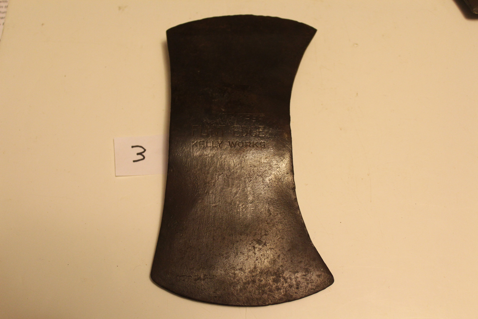

Since then I've been perusing some auctions to find a few more random axes to get back into working order and I just got a Kelly Flint Edge 2.2 double bit delivered yesterday. It looked to be in really good shape (I would venture a guess that it's hardly ever been used though I don't have anything to base that off of), but I threw it in some vinegar just to clean off the little bit of rust I saw. After about an hour I pulled it out and in the center of the cheek there looked to be a bit of bare metal, same with the cutting edges, but the rest looked to have some sort of black paint across it.
So my question is: did Kelly Flint Edge axes come from the factory with such a coating or was that likely put on at some point over the years?

The 1957 True Temper catalog specifies a "permanent black" finish on the Flint Edge axes (including cruisers), and the 1938 catalog specifies "cannon finish, black, with honed cutting edges" for the Flint Edge cruiser.

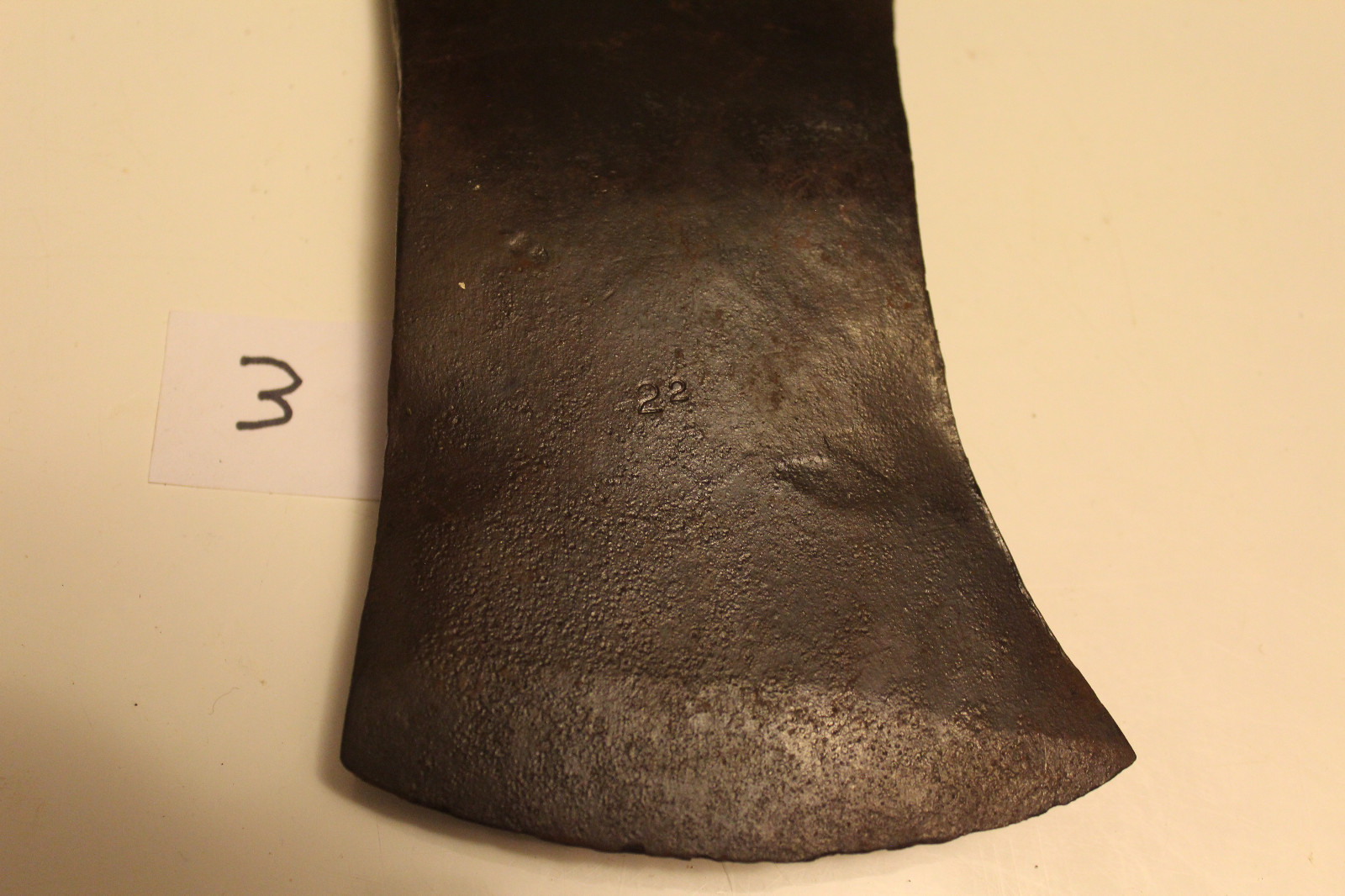

and I just got a Kelly Flint Edge 2.2 double bit delivered yesterday. .
Head weight on many axes is often stamped as 2 1/4 or 3 1/2 or some version of numbers and Steve Tall has suggested that the second (and usually elevated) digit indicates weight in quarters of a pound; meaning that 2 . 2 is 2 2/4. We've (myself, anyway) yet to see a 2 . 1 or a 2 . 3 to confirm this but it is curious.
I've read that somewhere (it's not my theory). Here's an example of that marking for 3^3 on some 3-3/4 pound Pulaskis:
I've seen a lot of posts on multiple forums dealing with the weight of axes, how they're numbered, and what category It puts them in (i.e. cruisers, felling, etc). It seems pretty widely accepted that the little superscript number is an indication of quarter pounds, but I haven't seen anything other than a two on most stuff either. Since it's not hung at the moment I'm going to weigh it when it comes out of the vinegar later today or tomorrow and see how close to 2 1/2 lbs it actually is. From what I saw already it looks like most of the hardened bit metal is still there and probably 95% of the black finish is still on it.

I'm not aware of a handy reference about axe stamp dates. Sometimes the old catalogs or advertisements will show the stamp, but this isn't foolproof. The Kelly Works name is said to have been used only after Kelly was bought by American Fork & Hoe in 1930. The actual stamping on that cruiser (shown below) looks identical to the stamping shown in the 1957 catalog. There are some advertisements which indicate that in 1960 True Temper started using the eye ridges, and some photos of Flint Edges having eye ridges show a label with no stamping on the head (as shown in this thread), so my guesstimate would be pre-1960 for that cruiser (if without eye ridges).
