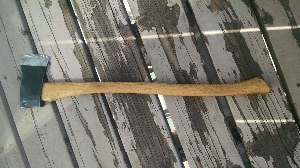

The GB Small Forest Axe will do all of this very well - and more. On the other hand, you could get in the game and find yourself a nice old 2.5 lb. head, dress it up nicely and fit a 19" handle on it. You'll feel good about your new axe because you built it yourself, and you'll have a new, fascinating hobby.
I think a vintage boys ax with a high centerline would work best for your described uses. I've never handled a GB but I do own an ax with what appears to be a similar profile. It's not near as good of a splitter as my other axes with high centerlines.
Boys axe or bigger for what you're describing. I have an SFA, and I wouldn't want to split more than kindling with it. I split a little wood every day, all winter to heat the house and it would be a long winter if all I had where hatchet weight heads. Plus, when I think of limbing, I think of whole trees that were just cut - if that's what you're doing, you'll very much appreciate 28" or longer handle unless you like working stooped over all day. My inseam is 30" and so I like 30" handles. That lets me work at my feet without stooping too much. A 3lb axe is a light duty do-all axe IMO. Add weight depending how how HD your splitting is. I think the 3-1/2lb axe is the ubiquitous axe head weight now because it strikes a good balance for general purpose work.

Yep, Just get you a vintage hatchet, boys axe and a full size axe between three and three and three and half pounds and don't look back. You can get all three for about half what a GB will cost you and they will perform very well.

Yes, location is key. Since you're in a hardwood area (I think) you should probably go with a vintage American 3/4 axe. The Gransfors Scandinavian will definitely do a good job of limbing and splitting kindling, but on cutting hardwood it will fall short. It's a limbing and crafting axe, better for soft woods like pine, fir, birch, aspen, and alder.
Probably 2.25 to 2.5 pounds. And you can get a 3 pound axe pretty cheap if you want to cut anything bigger.
Check out the Council Tool FSS boy axe 2015 Exclusive. It has 4140 steel and a Velvicut slim handle. My all time favorite for $60
