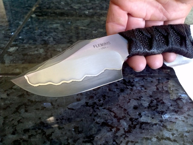

Got mine from Kelly Couples to make this knife...
Great job Eric... This does show the difference in using the nickle foil and not. When using the foil it prevents the carbon migration that gives the wild hamon looking effect. I like both methods, just depends on what the final desired effect is.
Eric, I drool on my keyboard everytime I see that knife. I think the general consesus I've heard is that the best man got a nicer knife than your son's Damascus. thanks for letting me know where you got it.
