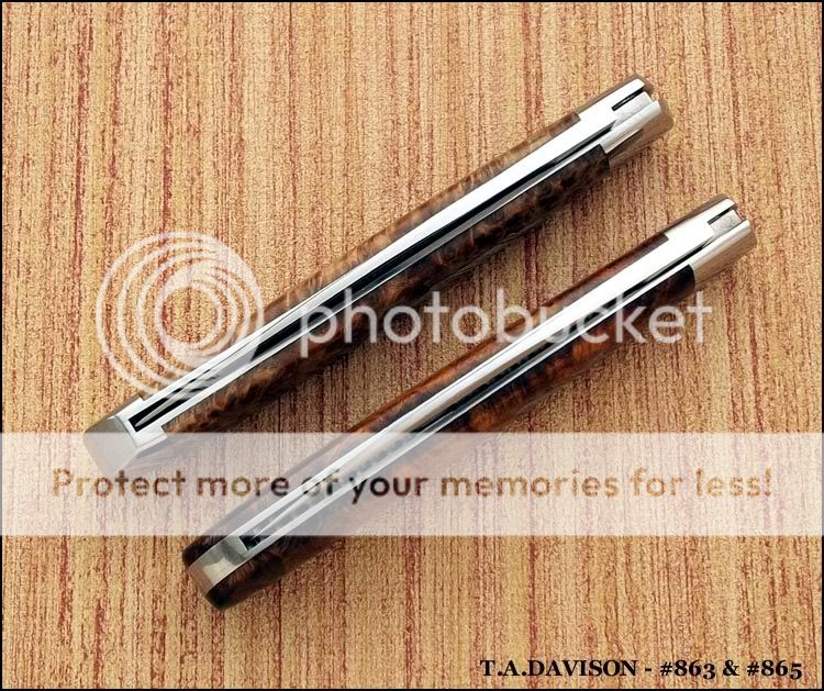

Here are a couple slip joints done.
These are true customs - why? Cause I did them from scratch. There is NOT another two knives in the world just like them? ( I did NOT use a pattern)
They are one of a kinds.....
Hollow Ground - free hand / on 14'' wheel.
I do my own heat treat - have done it for a very long time. (Kim Breed tested one a long time ago, said it was bad to the bone! Write up was in Blade Mag.)
I do a cryogenic quench on all blades.
The name is stamped in by hand / NOT etched.
Bolsters / stainless - I solder them on / they are not integral, glued on or spot welded. (you can NOT see the seam lines at all)
NO washers or pivot bushings - made like Reese Bose does his.
Shield - double pinned clear through the shield & liner. (NOT glued in or spot welded pins to the back of shield.)
There are no gaps. Spring is flush in all positions. (Most all my knives have half stops.)
There is no blade play - up or down or side ways. And the walk & talk is smooth. (The knife feathers perfect.)
Blade is centered perfectly when closed - and it goes clear to the end of the trough. (Looks like it hits the end, but does NOT)
You can NOT see the pivot pin.
Fit and finish is very, very clean......
Scales are always book matched.....
So I'm looking for feed back from you expert collectors....... What else can I do to make these knives perfect for you?
Seriously! Thanks in advance.
Todd Davison
#863 - Black Ash Burl - 4'' Closed.
#865 - Iron Wood - 4'' Closed.
Both knives are sold going to Alaska - enjoy the new knives Andy.
