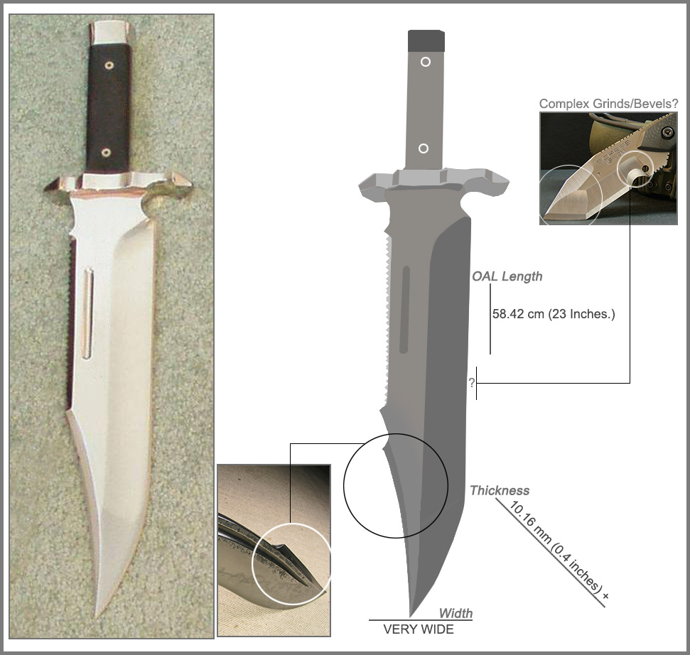

I tried to make a crude overview "design" of what I'm looking for -- it's not supposed to be exact, it's more of an illustration of the basics that I'd like. I used 2 pictures of other blade shapes to illustrate stuff I'd like incorporated into the design - I assume that is not illegal.. ? If it is, I apologize, and I will remove them from the picture.
The knife itself is a custom Bowie (Custom made by Hibben, I think.) someone posted on these forums. I asked the guy awhile ago if he was ok with me using his design for a custom, and he was. (If there's a problem, though, please let me know.)
This is a photoshop of the custom bowie, with some of the alterations I'd like - ie, the knife should be a bowie, but if a custom maker knew how to incorporate some more complex grinds/bevels into it, then that would be great.

As I look at this thread and these pictures I think you almost have to make a decision. A knife could be that size, or it could be practical and useful, but not really both. I'm estimating here but a knife that size would be 6 lbs plus I'm sure. Not trying to discourage you, but I wonder how prepared you are, for the cost of this. It's not a knife I would make for a customer, but if someone will, it won't be remotely cheap. Also, with steel that thick and a grind at that height, the bevel angle would be a lot more like an axe than a knife.

Just about any knife with a broom-stick handle like that is going to be uncomfortable to use, but a knife with the dimensions you're talking about and THAT handle would be damn near unbearable to use... :eek:
With SOOOO much steel hanging out there in front of the guard, you NEED a handle that will fill the hand and offer you control.
The combination above would have all kinds of lateral deflection.
Plus it kills the flow of the knife to have a handle that's half as wide as the ricasso, IMHO. But that's personal taste.
The functionality of the handle to blade is just physics. :)
Any knife with a blade thicker than 1/4"-5/16" is a club.
I like something between 3/16" -1/4" for a Big Knife...
