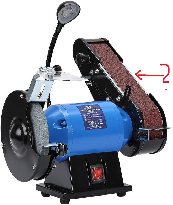

Looking to dip my toes into making knives - is this 2x27 belt grinder decent for under £50/$65?
Jun 12, 2006
13
From the research I've done it looks like a 1x30 sander is the go-to recommendation for a broke hobbyist, but what do y'all make of this? It's £46 in the UK which is quite a bit cheaper than the 1x30 sanders which go for something like £70-£90 in the UK, e.g. something like this.
Would the 2x27 sander be a better bet? A fatter belt would make things more efficient, but from what it looks like there's no way to adjust the angle on the belt side - am I missing something here?

Yup I'm in England. Looking for something on the cheap just to get started so those Aliexpress grinders are out of my price range at the moment. The first grinder is 50MM X 686MM (2"x 27") and it looks like name brand belts from 40-120 grit are readily available, but beyond that its unbranded aluminium oxide stuff which doesn't go beyond 1000 grit. Presumably I'd need higher grits for final polishing and sharpening?
My other concern with the 2x27 grinder is that there doesn't seem to be a way to finely adjust the angle of the belt side compared to the 1x30 grinder.
The pic is similar to my grinder. I grind with 36 grit, 120, then 220/240, followed by scotchbrite. I angled my grinder to suit my grinding style (horizontal), and modified the housing by cutting parts away so the thicker 36 grit belts and scotchbrite belts would fit. From the look the pic, I could use that grinder to do everything I do now.
Do you mean belt tracking? The black twist knob near the top of the pic does that.

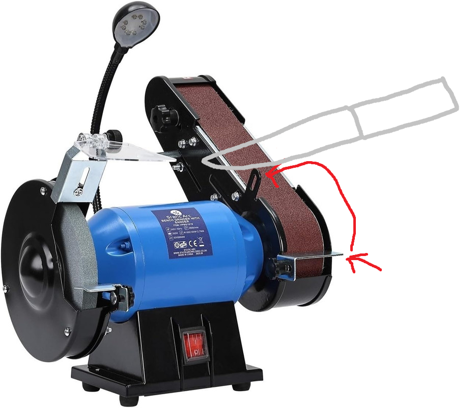

On the 1x30 grinder there's that little tilting table that can adjust the grinding angle from 0-45 degrees. Can I do something similar on the 2x27 grinder? It looks like I can move the little metal table on it to the upper mounting point and then adjust the grinding angle with the plastic knob on the side. Might seem like an obvious question but I just wanna make sure. 😁
Still not entirely sure what you mean but maybe this?
