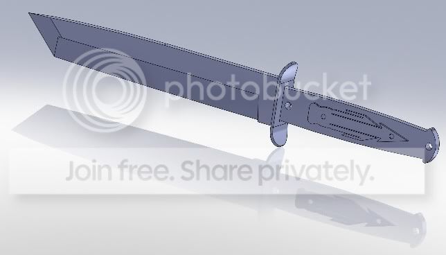

Hello all,
First off, I'd like to say I have been looking around the for a few hours. I love the site, and attitude of the users.
A little about me, I make punching and forming tooling for a living. I have multiple manufacturing machinery at my disposal, such as lasers, milling, drilling, grinding, and EDM machines, as well as a heat treating oven.
Okay, so I am looking to make my first knife, a few actually. My Great Aunt that introduced me, and my cousins to the great outdoors has passed away. I want to make a knife for myself, and for my two cousins that grew up spending weeks at a time outdoors with her, and her Indian guide friend. I hope to be able to finish by summertime.
I was thinking to use 1095 steel to make the knife into a tanto shape (seems easier to make with my available tools) and wrap the tang with Paracord. I have to admit I almost feel ashamed at how I had planned to fabricate the knife(s) after reading some of the threads, and viewing videos around here.
I planned to:
laser cut the profile
Belt sand the edges
Heat treat the steel,
Then Wire EDM the bevel.
Any suggestions, or warnings would be greatly appreciated.
Sample Picture (Shown w/ fishing spear tips):

Whoa all that equipment I am jealous. wire EDM-sooo jealous. I tried making a couple of small knives out of cemented carbide, it was a bitch to grind. my ceramic belts would barely touch it and I ruined 3 or 4, but still fun.
Anyway i am not really familiar with how EDM machining works, so I cant comment on its effectiveness. However that being said, I have never heard of anyone using it for a knife, at least a steel knife, because it can be realitivly easily machined in its annealed state. But you probably know better that I.
Ah darn it I didnt mak it in before the standard reply...;)
Thanks for the Standard reply. Lot's of good info there. I'm going through it now.
@Nebulae EDM stands for electrical discharge machining. It is used in tool and die making to "Machine" materials after they are hard. Materials expand and contract, when heated and cooled, as you all discuss here. In order to have an ultra precise tool, we machine first, heat treat, then make the final cuts. I can "cut" carbide no problem. The machine holds tolerances of +/-.00005".
