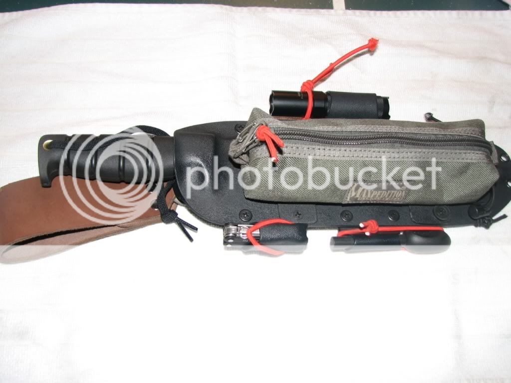

I built this set up for a guy using the maxpedition cocoon.
Good luck with your build.
James
Wow Bob, that is quite the knife sheath pack set up.
I hope you find what you are wanting. I will not be able to help ya lol.
Bryan
