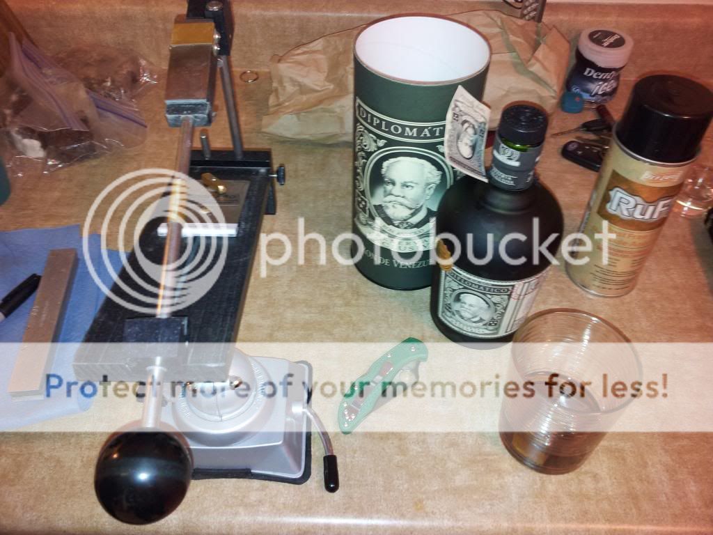

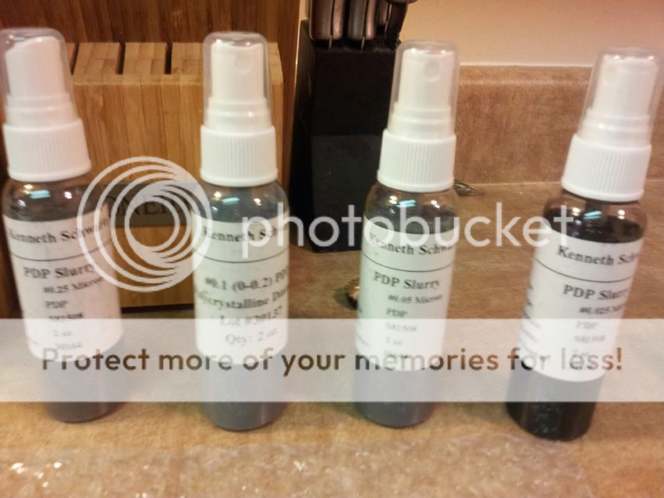

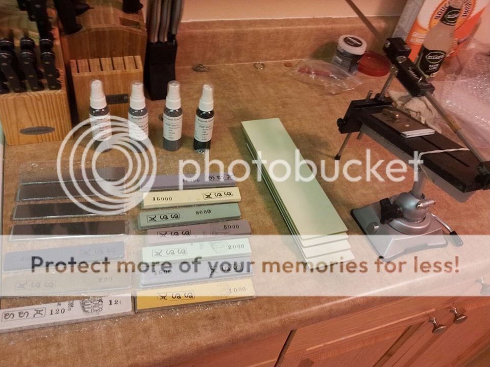

Stuffs for the edge pro from ken Schwartz and some of his famous polycrystalline diamond sprays for strops :)
Shapton pro stones 120-30,000 grit
Atoma plates from 140-1200 grit
Sprays from 60,000 - 640,000 grit (JNS)
Nanocloth strops mounted on glass. (3x11)
First impressions... Woooooow. Cant wait to get some more experience and get better. Been away for work for a couple weeks and came home to this :)

Put a 30 inclusive angle on a CS grivory paradox (hollow ground) using the atoma plates , then worked it over with the 1k shapton stones through a full progression all the way to 30k. Then stropped from 60k all the way to 640k. All I can say is wow , just wow.
My technique needs some refinement but its a blast.

No, i buy off the site. I have all the shapton glass except the 2k(out of stock), the 6K (seems a bit useless), and the 30k (out of stock). Just waiting for the 2k and 30k to be restocked. I really like the very buttery smooth feedback. I have been looking into some strops for my EP. how do you like the nanocloth ones? The website was turned my $650 edge pro purchase into well over a grand, and still not done. I think I'm going to get the 1/2 inch stones as well.

Hehe , I get my stuff direct from ken himself. That's why I only bought the base model EP Pro , I knew I was going to be getting this stuff down the road so I saved that money and put it towards this stuff. So far I am very very impressed with the nanocloth. It itself has no direct affect on the edge. Moreso it just presents the abrasive to the blade without having so much give that you just round off your tip. Only played with this for 2 days and im already well beyond whittling hairs.
With the nanocloth I recommend kens Monocrystalline , Polycrystalline or Cubic Boron Nitride sprays and emulsions.
How do you find the GS stones for loading. Certain stones (the 2k comes to mind) and the higher grits (15k and 30k) seem to load fairly easy , not sure if its technique or what. Gonna give em some time to see if they break in a bit.
