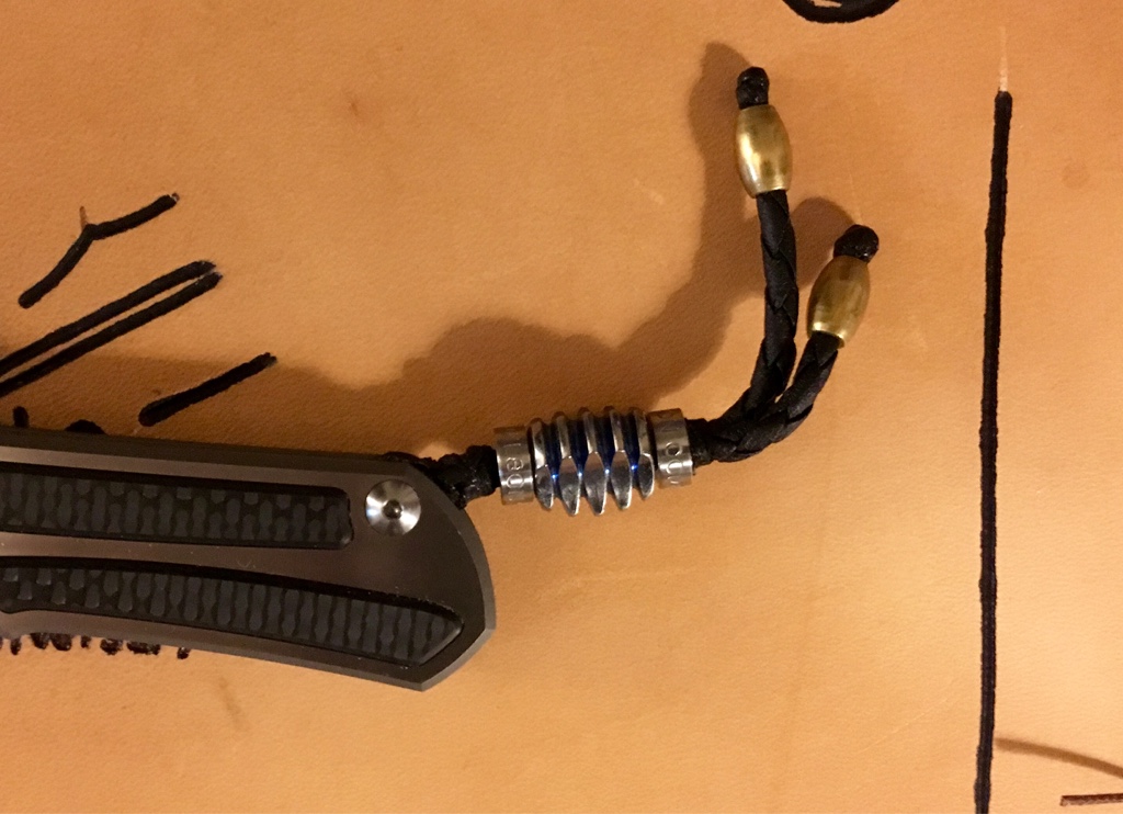

Cut your paracord at an angle, melt to create a point, place through hole in lanyard pin (I will assume that is what you are referring to when talking about a tube) and pull through. You only need to remove either three or four inner strands of the paracord according to how stiff you want it. I make custom lanyards using both CRK beads and customs and it's quite easy.
