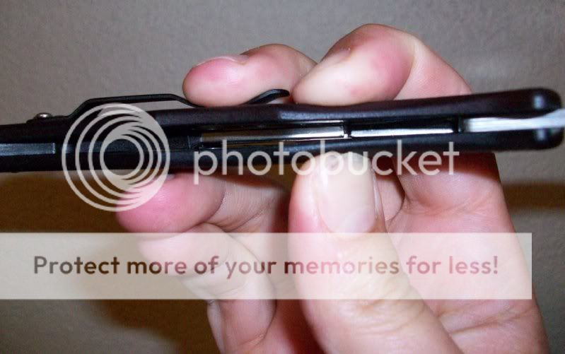

Anyway, I got to thinking about what I posted about my Endura's handle flexure, and it was bugging me that I might have said something incorrect or exaggerated an observed condition. So I pulled some folders out of the drawer and did a little experiment.
See, the thing is that for whatever reason I really remember the older one-piece molded Zytel (FRN) handles being very stiff, and the flexure I am talking about comes from pinching the handle scales between the thumb and forefingers as shown below.
Coincidentally, you have to pinch pretty hard, and with the Endura 4 you get maybe 1 mm of movement at the exposed/unsupported edges of the scales near the center of the handle.

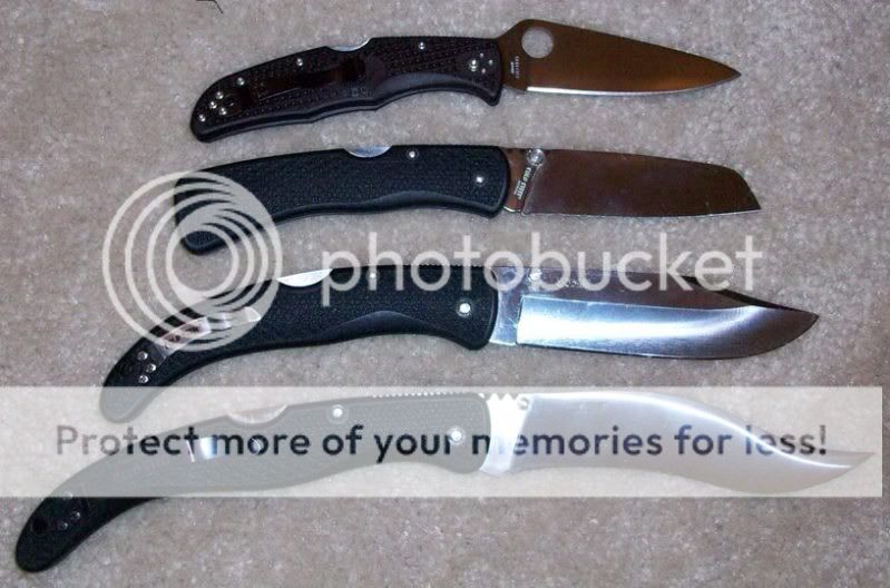

I tried this with three other zytel-handled knives. These are all Cold Steel Voyagers, which are the knives that for whatever reason made me think that one-piece cast Zytel (FRN) handles are laterally stiffer. Stacked next to the Endura you have a 4", 5" and 6" blade model, all with proportionally longer handles.
I gave each one a squeeze and basically found that the Endura 4 is just as stiff as its predecessors. As handle length increases I would get proportionally more flexure from pinching the middle of the handle. It's just like all of those simply-supported beam problems we studied in college. The farther the distance between supports at each end of a beam, the more the beam will flex for a given force.
SO!! What does all this mean?!
1. It means that Sal and his guys over at Spyderco are cranking out kick-ass products that get better with each design iteration!
2. The perceived difference in flexure between the Stretch and the Endura that I experienced was a matter of handle length and geometry. The stretch had a significantly shorter handle compared to the Endura, and therefore a proportionally higher stiffness.
3. It means that I can sleep at night knowing that I'm not crazy and that I'm dragging anyone's name or product through the mud.
4. It's another data point LawyerSam can use when he decides to pull the trigger on a new Spyderco Delica at some point in the future. (it's gonna be a stiff, hard-working, little cutting machine).
