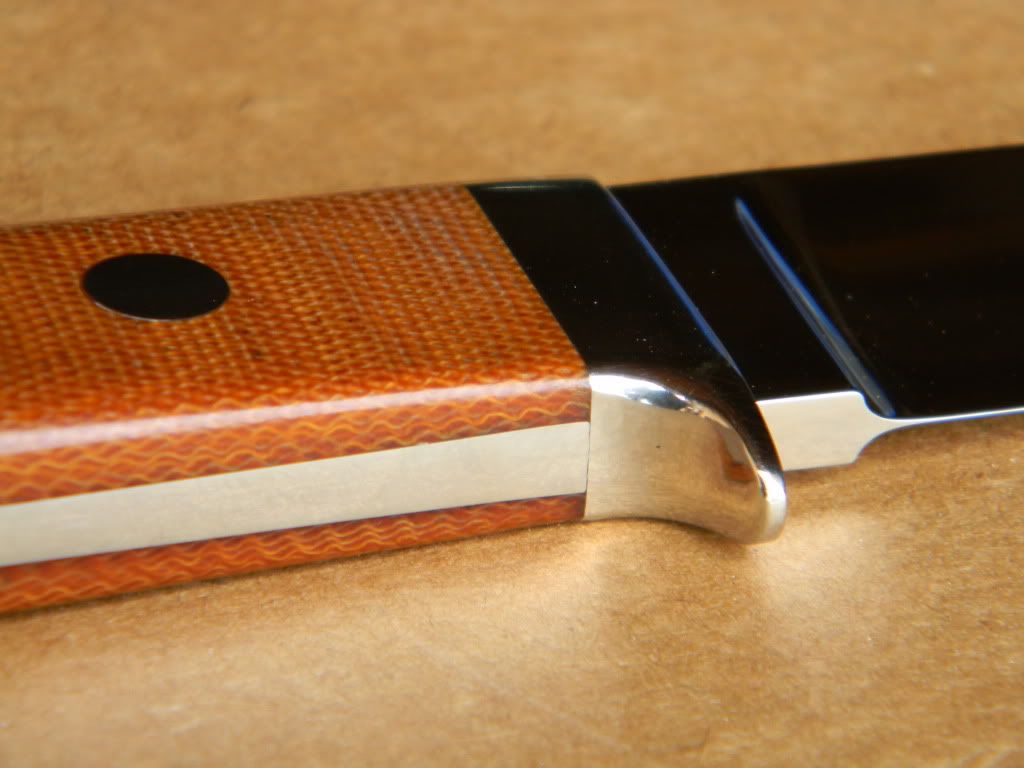

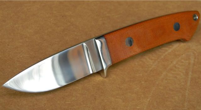

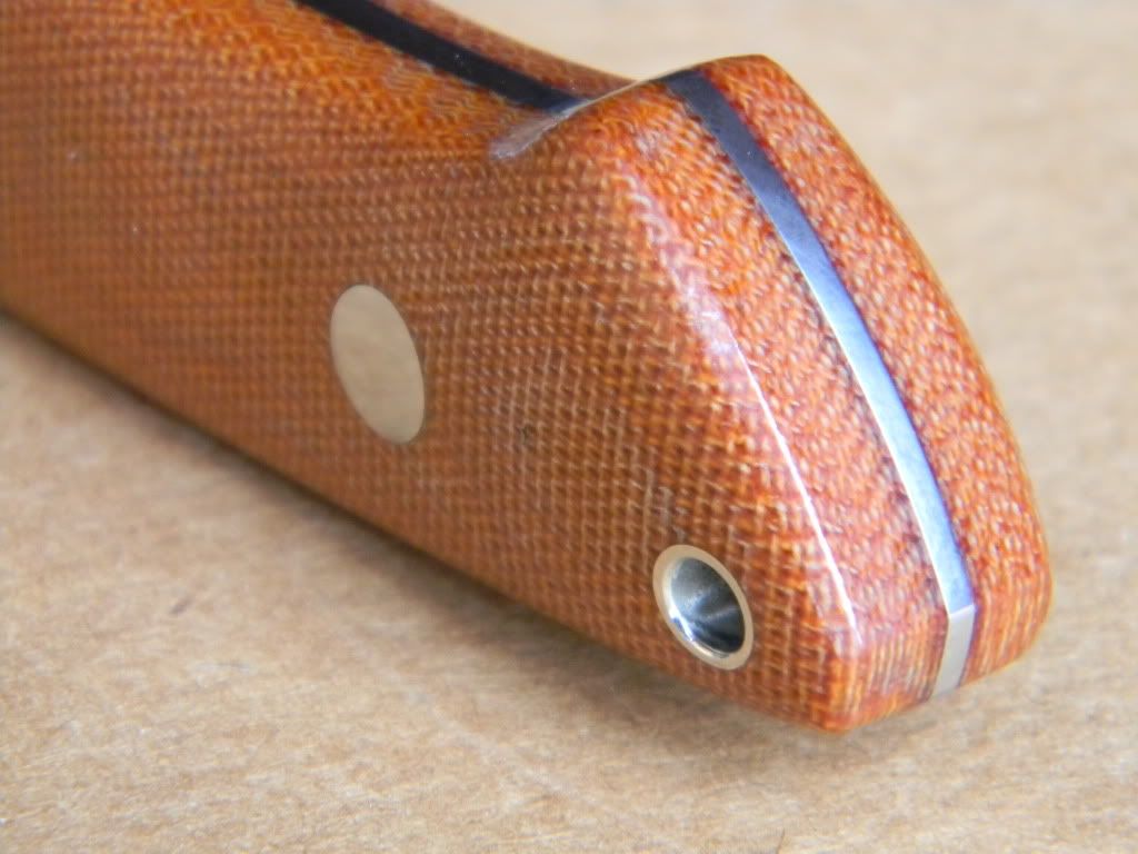

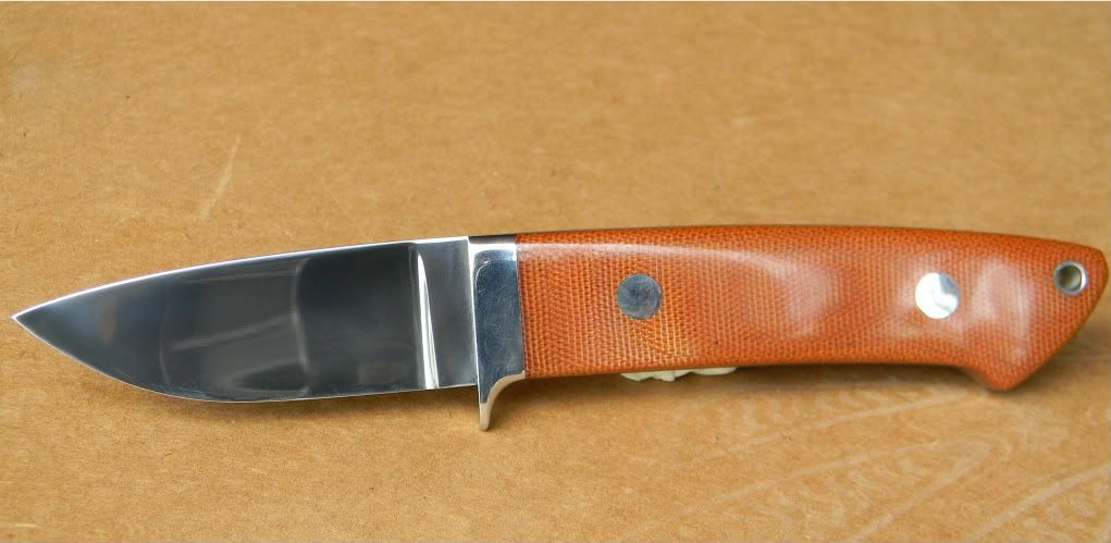

I started this knife about a year ago,got very frustrated with hand filing the guard so it sat until a couple months ago.
having lots of trouble with the mirror finish on the blade. Tried hand sanding from 400 to 2500 about 3 times, and norax to x5 a couple of times , and SR Johnsons cork belt.
I'll try to correct the problems on the next one.
This is my best F&F to date, still need improvement in all areas but pretty happy over all.
Thanks for looking, hope you enjoy it.
Ats 34
SS fitings
pinned guard no solder
73/4" OAL
