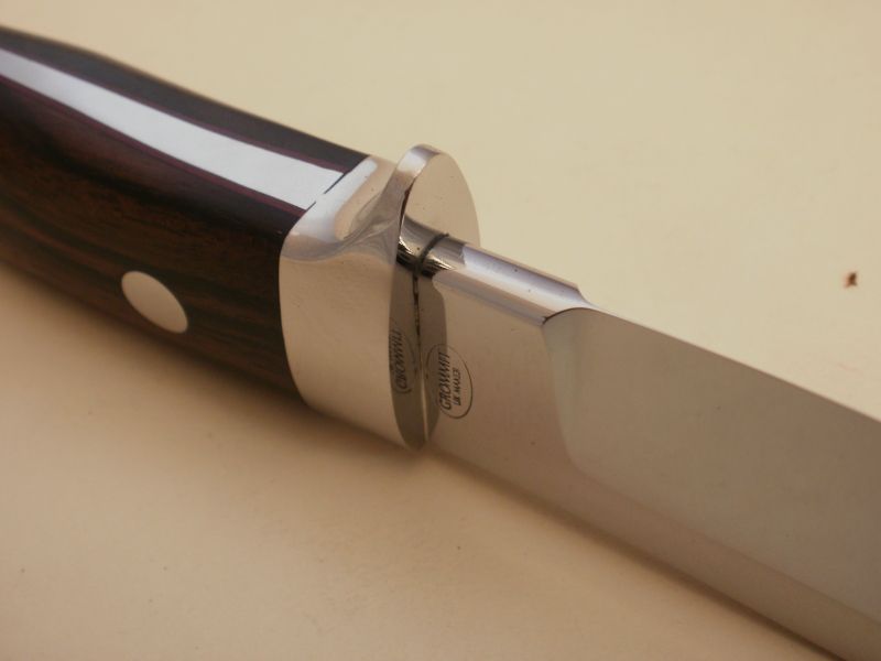

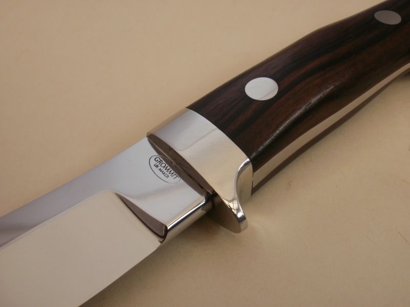

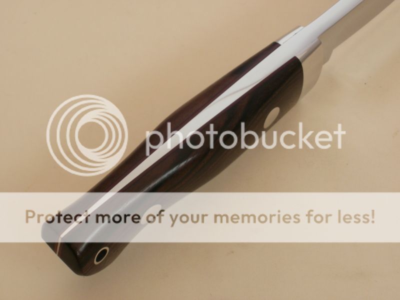

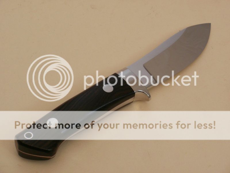

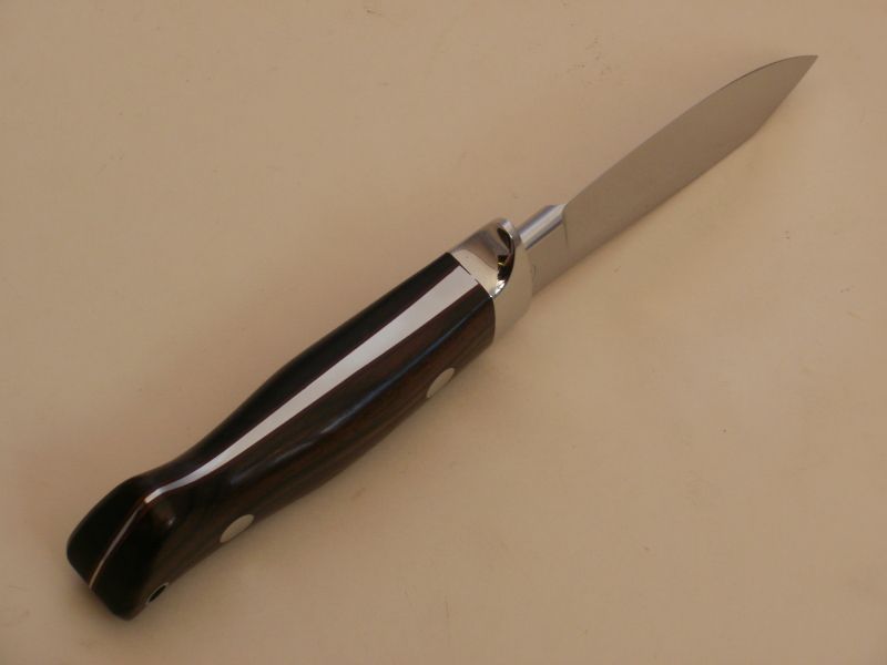

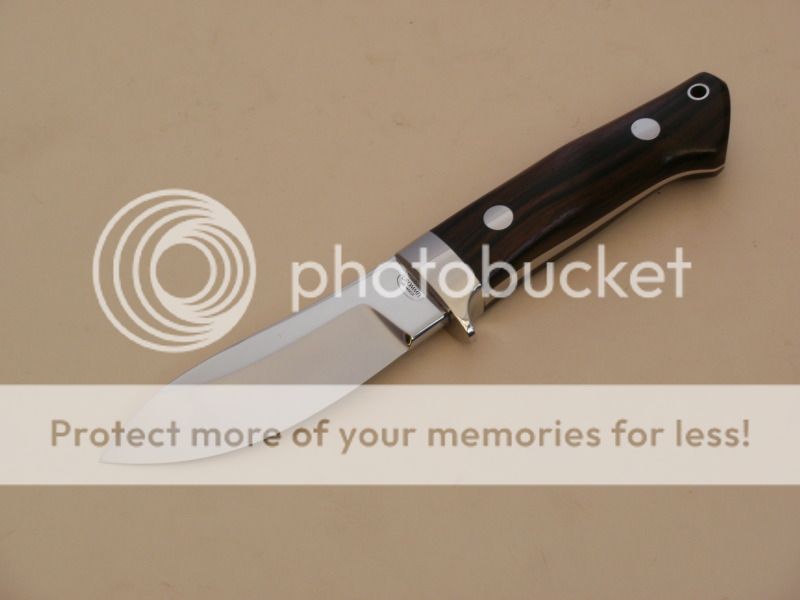

Hello all,
Been a while since I last posted my work.
I just wanted to share with you a of project I started whilst been given the chance to train at Ian Bailey's for 2 week.
My main effort was to get hands on with the hollow grind and after great advice from Marcus Lin and the guys Ian watched with keen eyes.
It's definitely not an art that can just be mastered straight away.
A error either side on the guard on the Nessmuk but I am over joyed with the result.
As always looking farward to comments from you experts.
This is a Loveless Style Nessmuk.
3 3/4" hollow ground blade of 01 Steel
overall Length 8"
Macassar Ebony handle with red fibre liners on a tapered tang
fittings are 304 stainless
Thanks for taking the time to look.
Brian
Very nice Brian!!!
Do you have large hands? If not you may try slimming the guard and the front of the handle. And as you guys get accustomed to using wheels you may want to push for a full height grind (no flats).
having had one of marcus lin's loveless interpretation i can see a little bit of his 'influence' in your knife
Thanks very much guys,
David, a full height grind sounds something I should try.
Regards,
Brian

Mind you I struggled a bit with the hollow grind but stuck at it slowly.
The original handle of buffalo horn went wrong which was a little upsetting.
But I really like it, learnt a lot from doing this one.
Regards,
Brian
- ooh, lekker man! Such a beaut, Bri
Just, please - next time you have it photographed so nicely, please wipe yer fingerprints off, mate!
Paul,
Was wondering when someone was going to see that...was gutted when i saw it..
the photographer is getting a clip round the chops lol!!!
