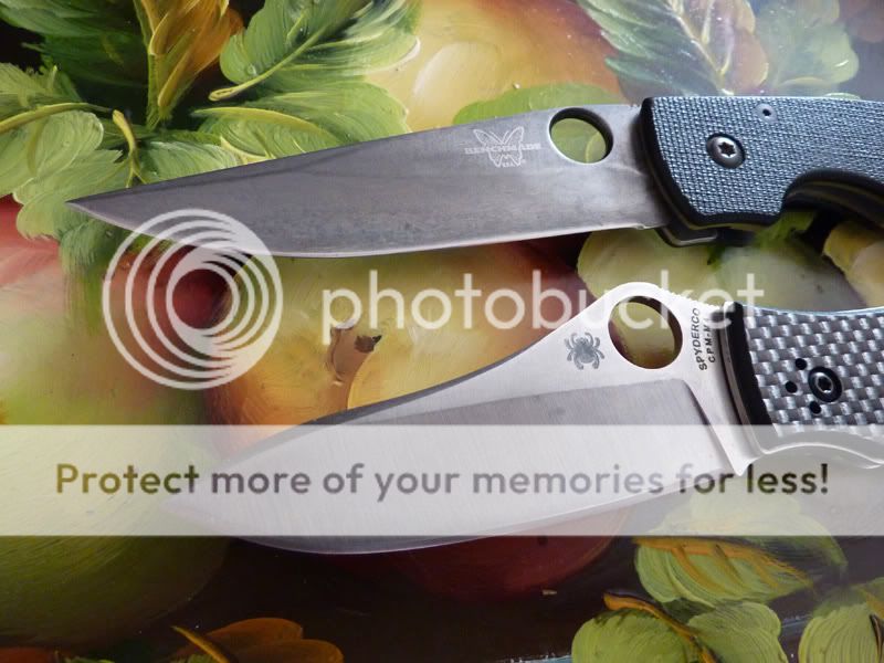

M2 speed steel isn't stainless. As a high carbon steel it is prone to discoloration. The reason I've been cutting limes (aside from the need for sliced lime) is to speed up the discoloration process and make it more even. It's almost like bluing the blade. Controlling rust with "rust". Once an overall patina is achieved it's gonna have that old school look AND it will be somewhat better protected from huge ugly fuzzy brown rust spots. Hope this makes sense. Maybe someone else has a better way with words.

M2 and CPM M4 are not "carbon steels". 1075 on opinel, Fred Perrin customs knives or 1095 on old Schrade or ESEE knives are Carbon steel and getting a patina with a blink of the eye.

I love carbon steels and I love to get patina on them. M2HSS and CPM M4 are totally different animals.
Here is a picture showing a BM AFCK HS with M2HSS blade
and the Spyderco Gayle Bradley with CPM M4 !
Each steel is very different and is not made through the same process. (One is a CPM !)
Two knives that I really love as they give the most modern design with a non stainless blade and M2 & CPM M4 makes great knives for whittling. (it cuts and leaves some kind of "patina" on wood. The best woodchisels are made in M2HSS BTW... there is perhaps a reason.)
Both has been used as EDC without the purpose to get a patina.
The M2 got its patina very quick and I was not able to get rust pots on it (even used on sea shores).
CPM M4 is not getting patina very quick. I was not able to catch the blueish reflection on the blade but despite two little brown spots there is no real patina... yet.
All my M2 knives developed a patina in a week of use.
I got my M4 GB for two months and use it daily and if it doesn't shine anymore like a CPM30V blade, it is not yet dull grey.
I clean it with hot water and wipe it. That's all.
Someone else on the forum has shown a picture of a GB after all a night in mustard. The patina was beautifully dull grey.
Now I don't feel like "forcing" the patina" as CPM M4 looks very stain resistant anyway and I'm not considering to leave the blade all night long with acidic goo on it.
I have even started a BG Patina Thread for comparaison purpose but it's now in oblivion...
With the GB, I have been cutting some sticks of wood all this morning and trimming some plants. The picture was taken after I clean the blade and strop it five times on my leather belt.
