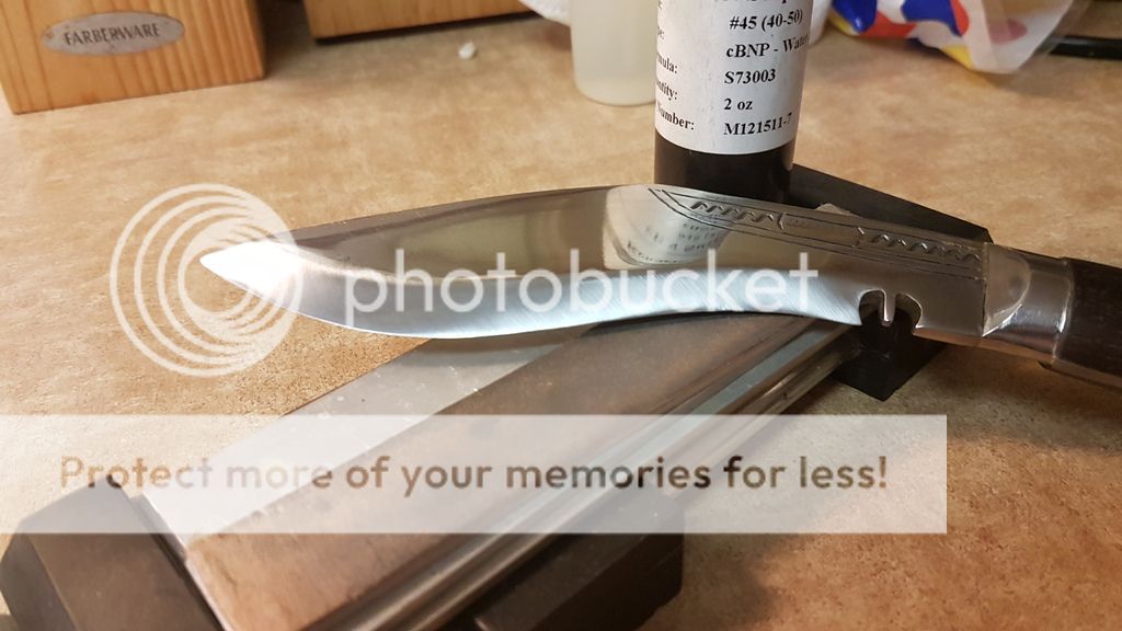

So i have this mini Khukri. It was stored dry, but developed some rust on the blade. I was only planning on removing the rust. I wound up using some cbn on a cotton cloth to polish out the corrosion. Then realised that the knife would barely tear paper. Clearly not acceptable..
Now i dont sharpen convex grind normally, nor scandi grinds for that matter. So I dont have the sandpapers and things needed to handle a project such as this on hand. But i do have a pile of kangaroo leather strops and high quality compounds from Ken Schwartz.

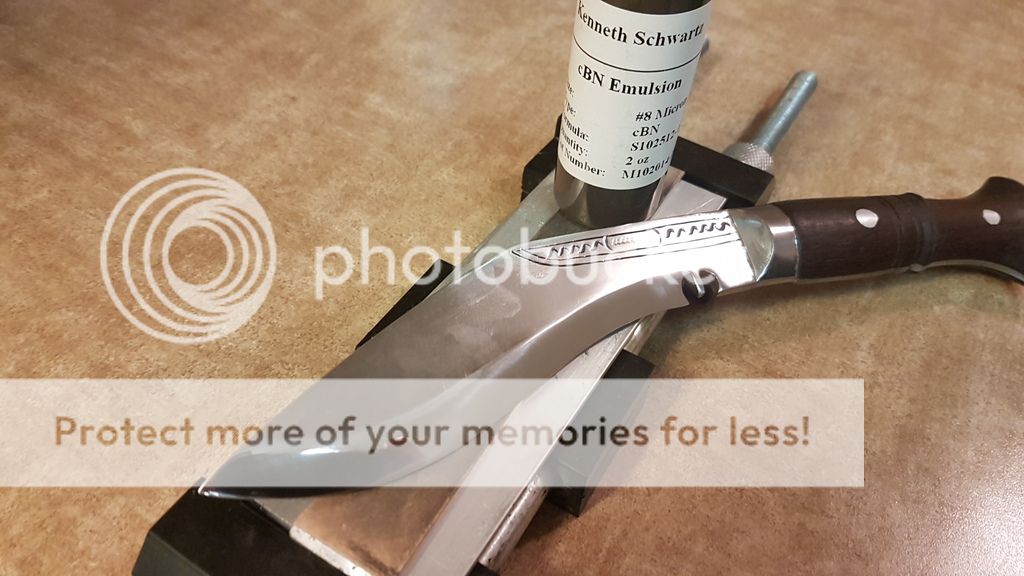

So I set to extreme low grit stropping. Dropping all the way down to 45u to get both sides to meet. Then back up to 30u, 16u and 8u respectively. The knife now slices and push cuts well (especially given the convex grind and obtuse geometry).
Given the knifes POU (wall hanger), I saw little point in continuing. But this could be further refined to as fine as necessary.
I am pleased with the aesthetics and sharpness achieved.

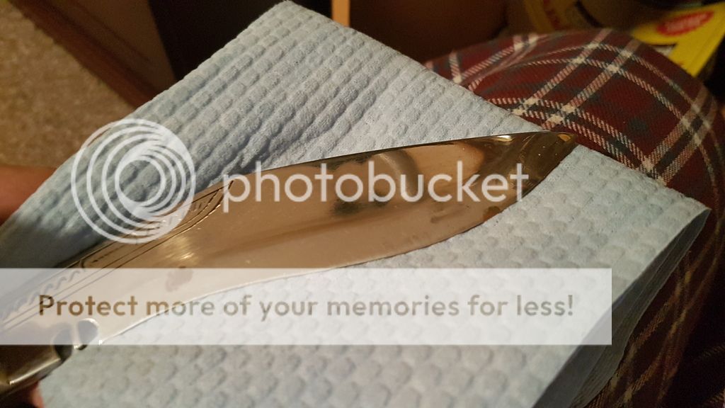

Corrosion :(
45u CBN on rough side of kangaroo
8u CBN on smooth side of kangaroo
How much swarf do you get from the 45 micron strop? It doesn't look like very much in the picture. Do you clean it with every use?
Its not a strop i use regularly. Its definitely darkened significantly for being used so little. But that happens even with 0.025u poly diamond from ken. I originally tried starting at 16u CBN and applied 3 drops of fresh compound to that strop and went to town for about an hour. But couldnt get the edges to meet. That strop is black now and needs cleaned. I only spent 5 or 10 minutes on the 45u strop so its not as dirty.

Yeah I spent about an hour on it initially, taking my time and learning. But it wasn't coarse enough to get both sides to meet so i wound up dropping down to 45u. Things happened rather quickly there. Then i went through a progression 45u, 30u, 16u, 8u.
Its fast when you use the right one (the knife was rougher than I initially guessed), but gentler than comparable stones. Its extremely fast on a powered system, such as a WSKS, WSKO, 1x30 or 2x72...
