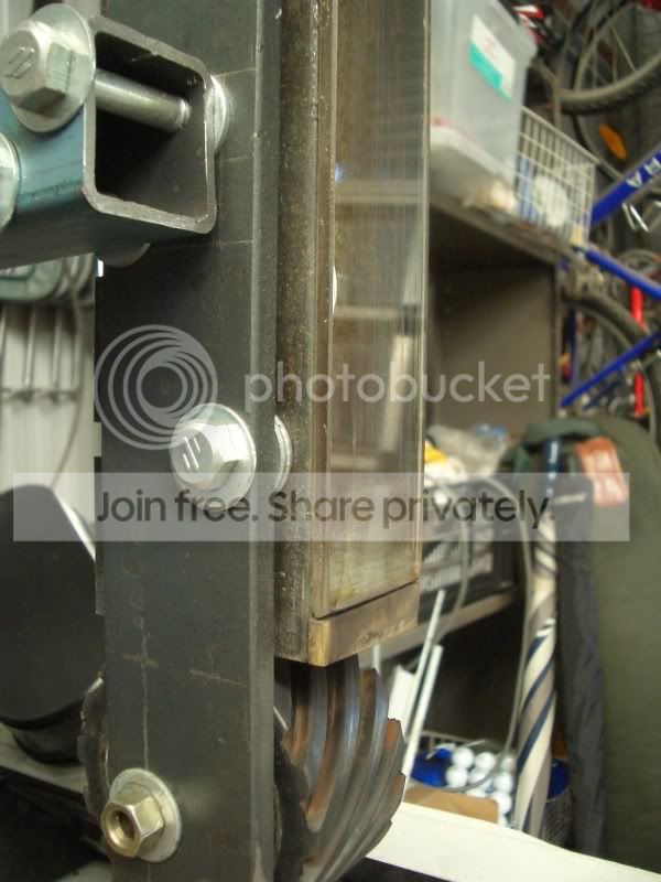

Does your platen have a metal "shelf" for the glass to rest on?
You need to bolt or weld on a piece of 1/8" metal below the glass platen. The JB will probably hold for many years, but if it fails, it is not a happy moment. I have one that I epoxied on and lasted until I used a torch to remove it. I had another that fell of in 6 months. Luckily it fell off when I was removing the platen.
i'm not saying my way is better, just different.
I took a piece of 1/4" brass the width of the platen and soldered it to create a shelf
Bill I am going to assume that by metal shelf we are not talking about this
the adjustable bracket on which the glass platen is actually epoxied?????????
Here is a couple of better shots of the glass platen installed on the machine.
I am going to assume Bladsmith you are talking about a piece simialar to what FTODude is picturing in his photo.
So if I am following everyone here then there needs to be a retainer for the ends of the glass to keep it in place if the epoxy fails. I can handle this even though I have never heard this subject mentioned before in all I have read or heard about platens and the glass installation it sounds like a good fail safe.
The metal plate is attached by 10/32 cap screws from underneath the metal plate to arms that come out of the platen body allowing it to be adjustable up and down with 1/4x20 cap screws you see in the pic of the finished platen, allowing for height adjustment on the glass itself.
I will come in under that and add a brass clip that will bend up at each end of the glass and basically lock it in place in case of epoxy faillure.
I had drilled the plate that the glass is epoxied too so that it would get more of a bite but I can see the advantage of the retainer! Live and learn, never too old of dog to learn a new trick!!!!!!!!!!:eek::rolleyes::D
Thanks for the heads up on this subject!
Yes, that is what we are talking about.
You only need it on the lower side of the glass, but both ends surely won't hurt..
