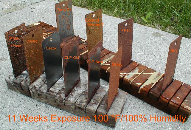

I agree most knives don't get maintained properly and it's a major reason why they die prematurely, develop wear that leads to blade play, and eventually to where the knife is no longer safe or practical for usage. But there is still a big difference between any oil and the right oil...some products on the market are mainly useless and others are just plain snake oil (Militec-1, which in many cases makes rusting worse than uncoated!!!).

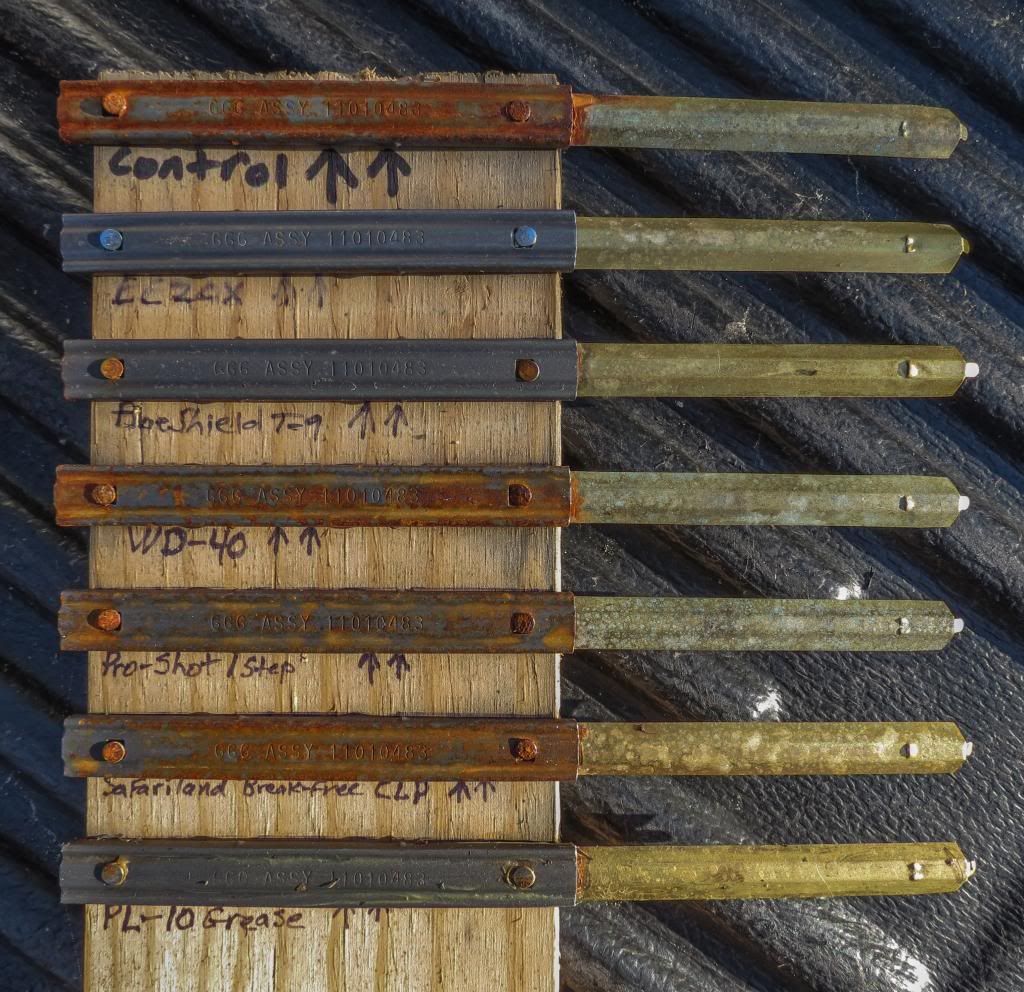

For example, Eezox and Corrosion-X demonstrate corrosion resistance that is really unmatched
http://www.m4carbine.net/showthread.php?103924-Corrosion-Testing-(New-Pics-5-08-12)/page5
http://www.6mmbr.com/corrosiontest.html
http://www.ar15.com/forums/t_3_7/630802_Backyard_rust_test_part_2.html&page=1&anc=bottom#bottom
