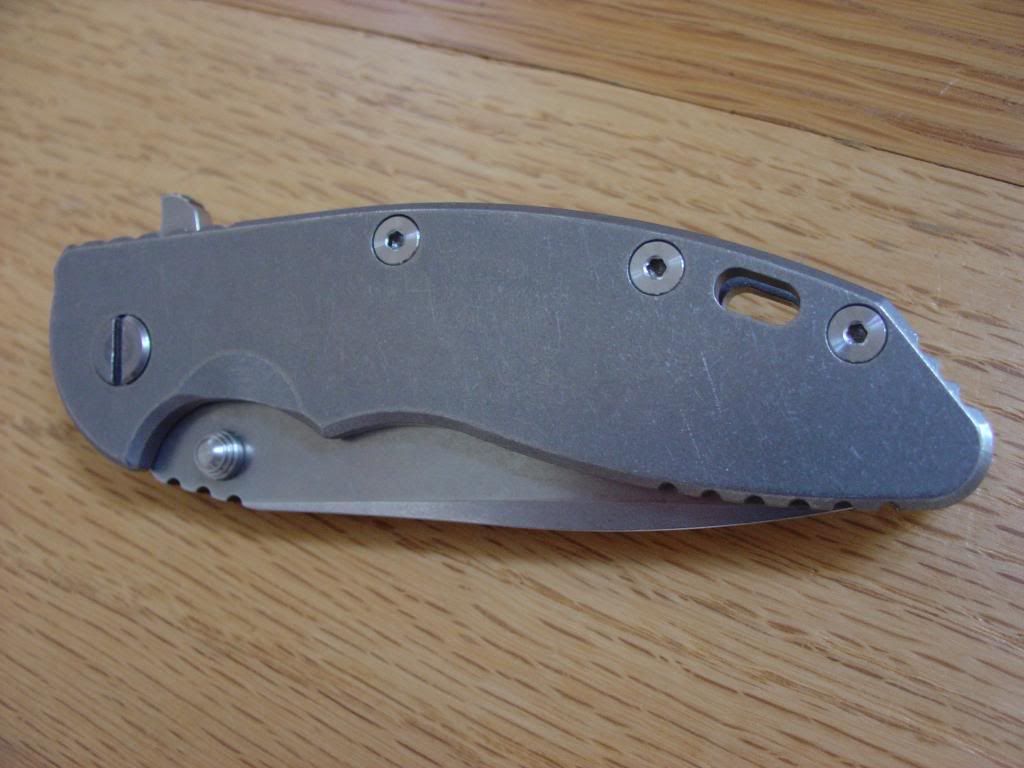

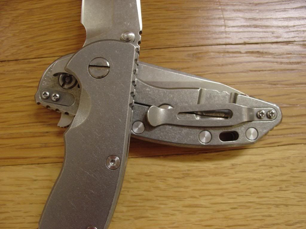

Didn't like how the bead blast contrast my stonewash blade and locking side, so I decided to stonewash the scale myself. Took some 1500 grit to it first for 5-10 minutes, then into the media of ceramic and natural stones for a quick stonewash.
Tried to capture the finish best I could on camera. It looks better in person I think for sure. I think you can tell better in the pic where I compare the stonewash locking side of my slicer with the Ti scale I just stonewashed. The stonewash I applied is pretty close to what the blade and locking side look like, I am very pleased with the results. Hopefully more of the Ti scales and standoffs are in the works. It really does make the knife feel like a beast! (more so than before
