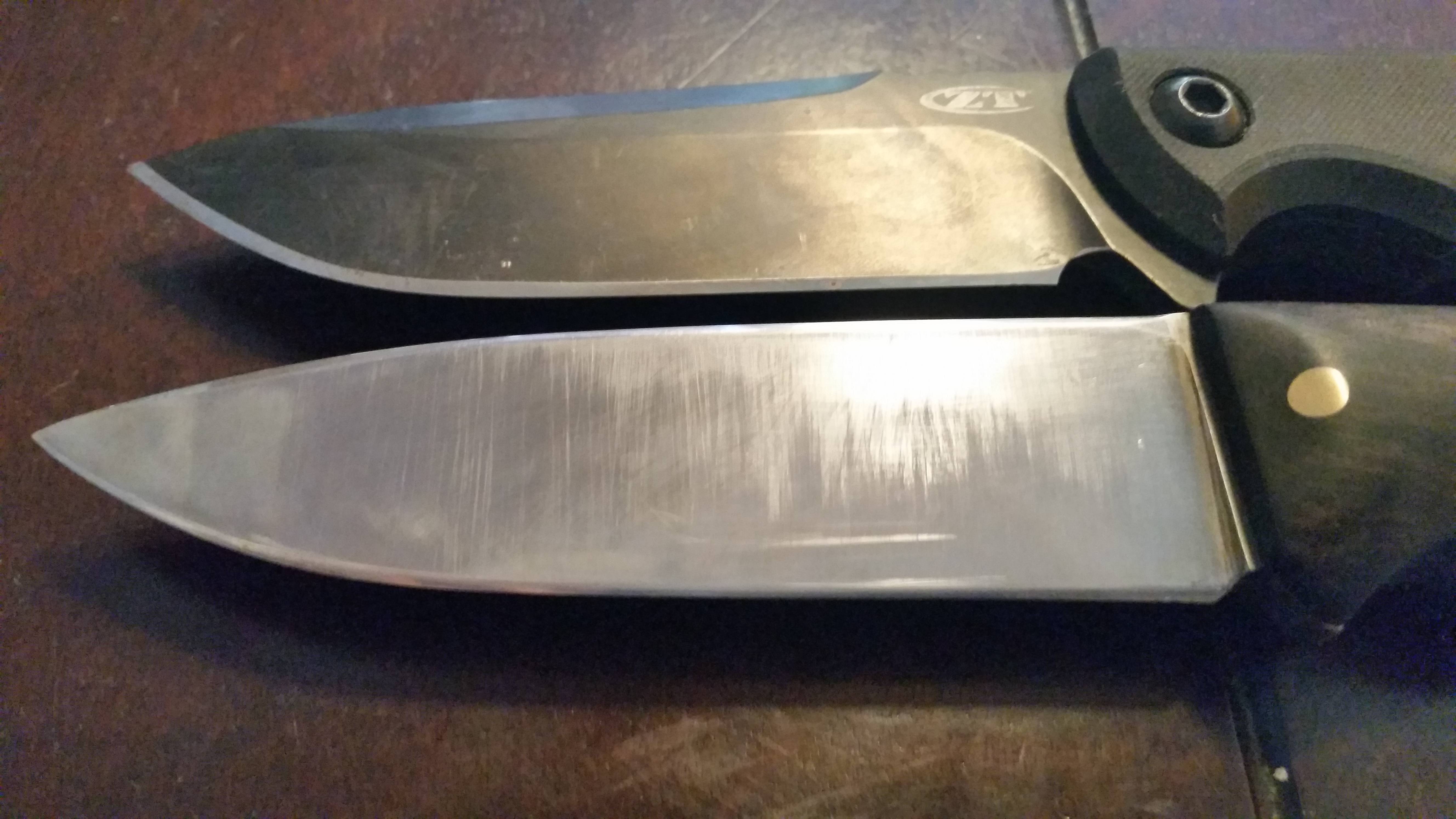

Out of the box:
I don't know what the thicknesses behind the edge are but you can see Luong's (on the left) is easily thinner.
Spine thickness is about the same at the thickest:
Blade length and width are about the same with Luong's being a little longer, the picture gives a little bit of a false perception regarding width:

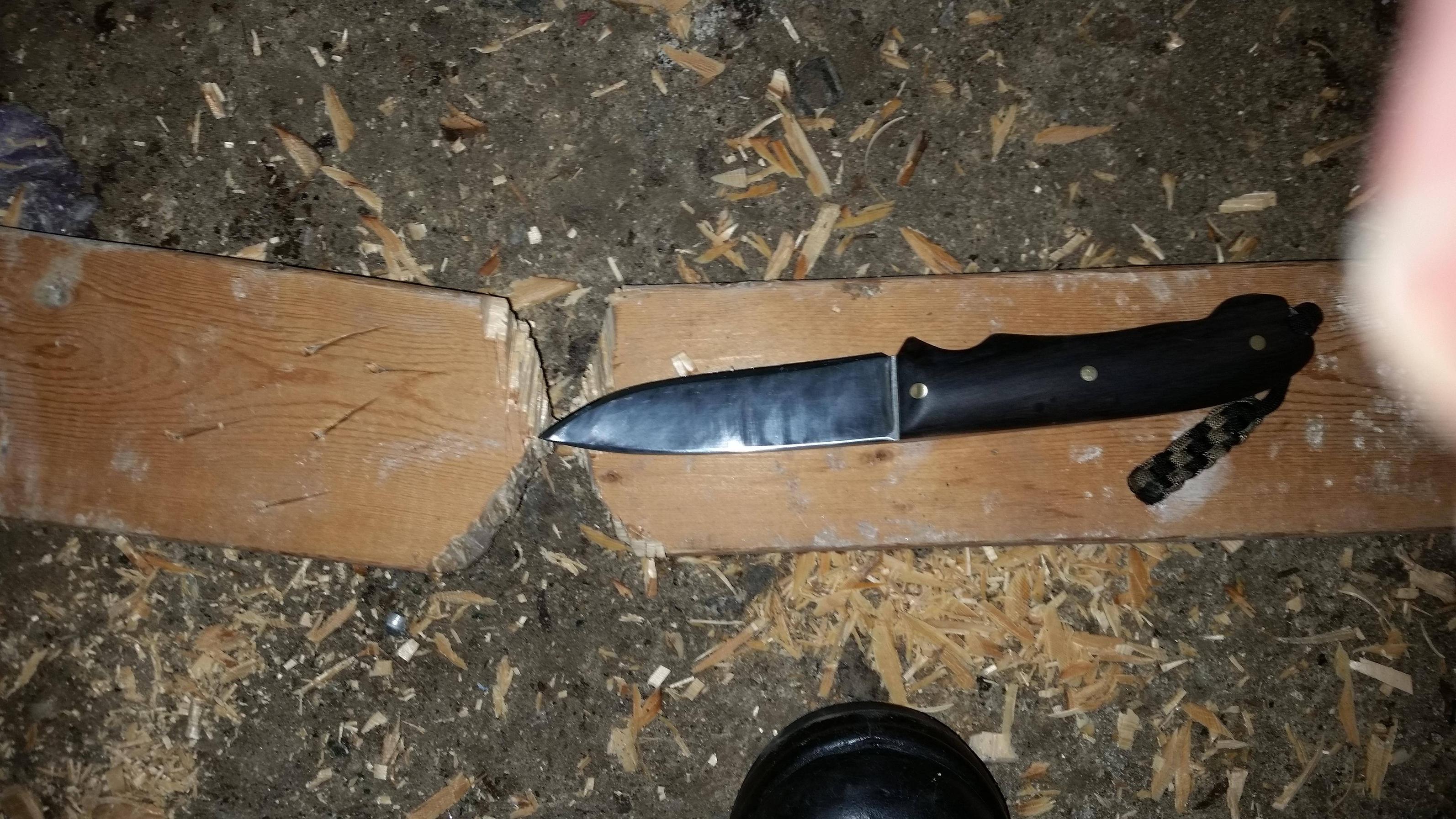

I finished up the tests today and now its time for the results. The knife was comfortable throughout. When I dropped the edge to 15 degrees per side it left very little steel to support the edge. I knew that I was going to push the knife into uncomfortable territory by trying to replicate most of the tests I did with the 0180. To start with I went to the same tree I cut down with the 0180. I cut through it easier than with the 0180 but the edge was too thin. It started rolling a little bit. Not bad, but enough to where I knew I'd screwed up and took too much metal off and made the edge too thin. I went back and put another bevel at 18 degrees per side. The edge and the primary bevel behind the edge were still clearly thinner than the 0180. I started to wonder if the knife would perform well. I pushed forward, at this point the knife is going to sink or swim. I went to the same barn as before and cut basically the same stuff using the same methods, basically cutting, chopping, and stabbing whatever I might need to do with a knife plus a couple extra things that would simply test the steel.

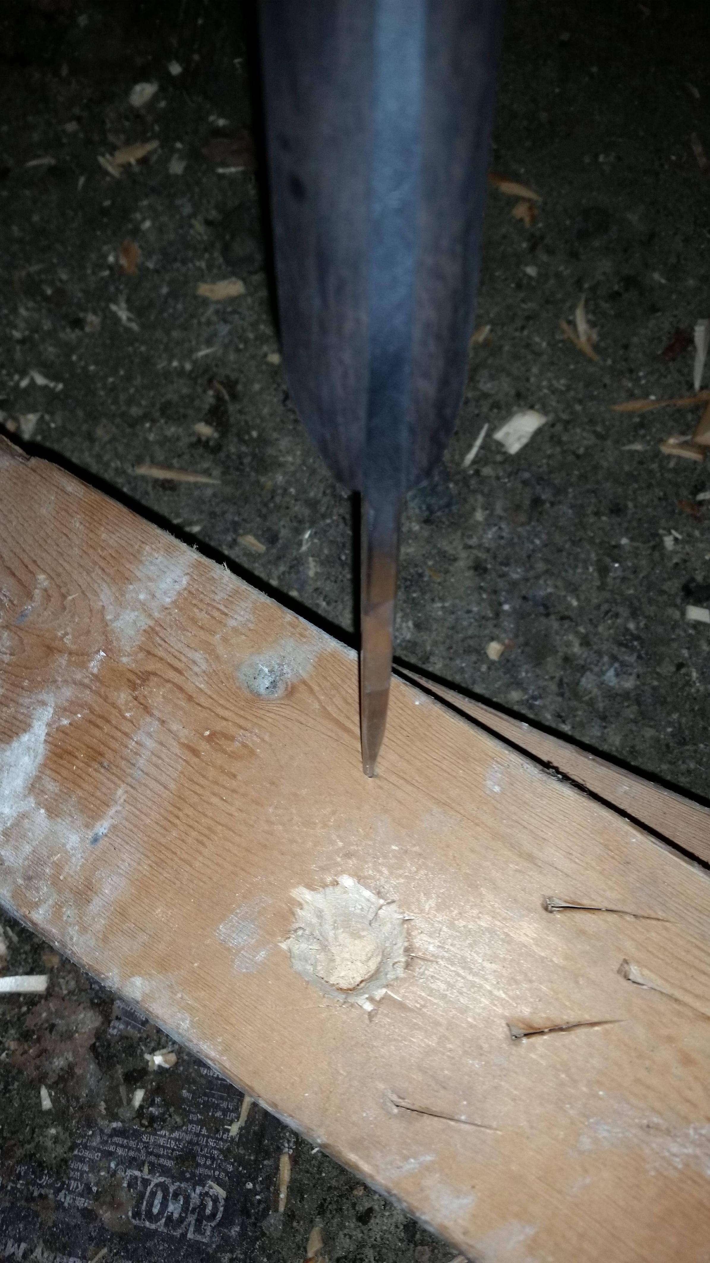

It's hard to tell but I awled into that piece at least an inch deep.
Basic prying to see if the tip was strong enough for the upcoming abuse.

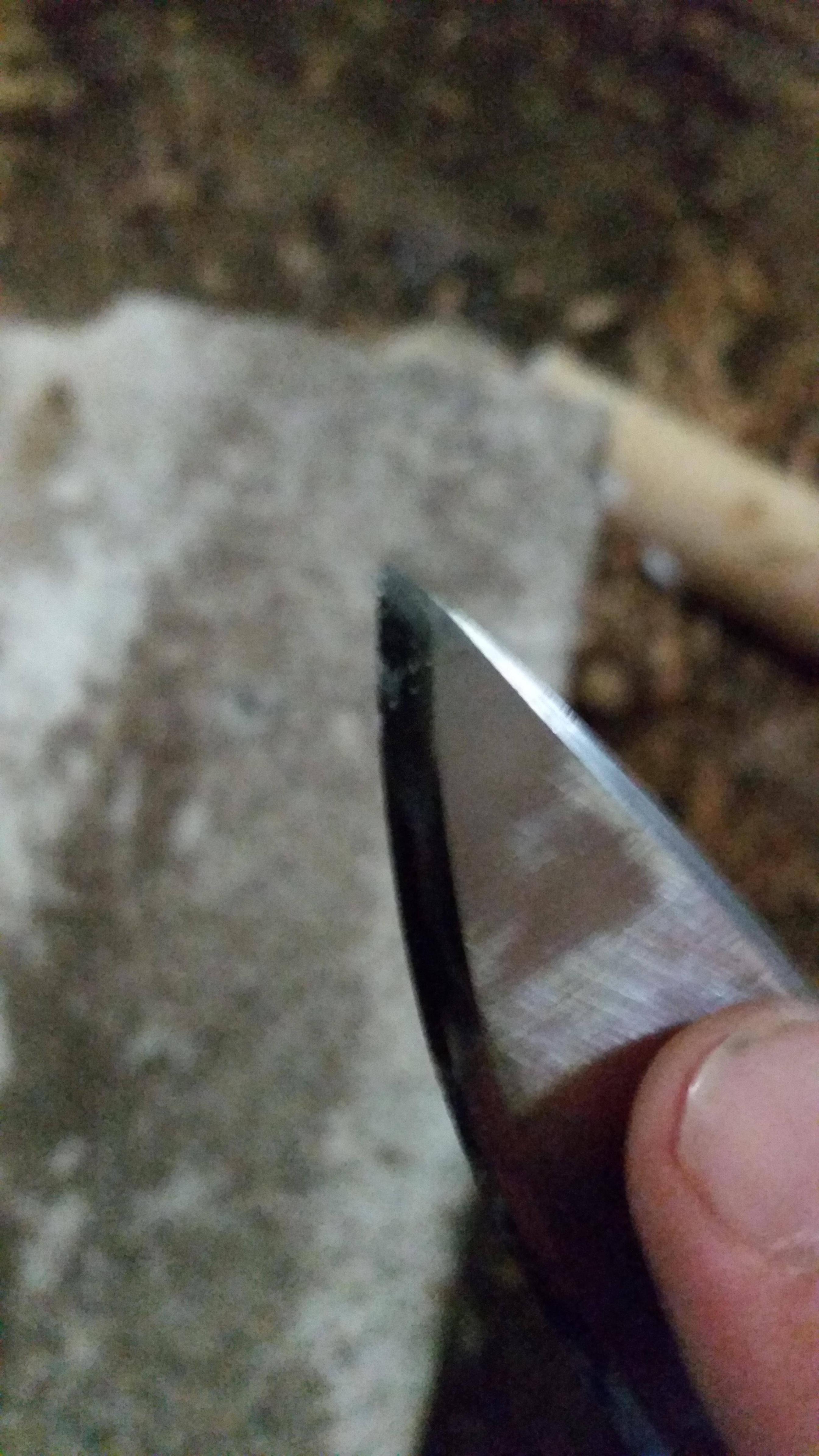

This was the edge at this point, some degradation.

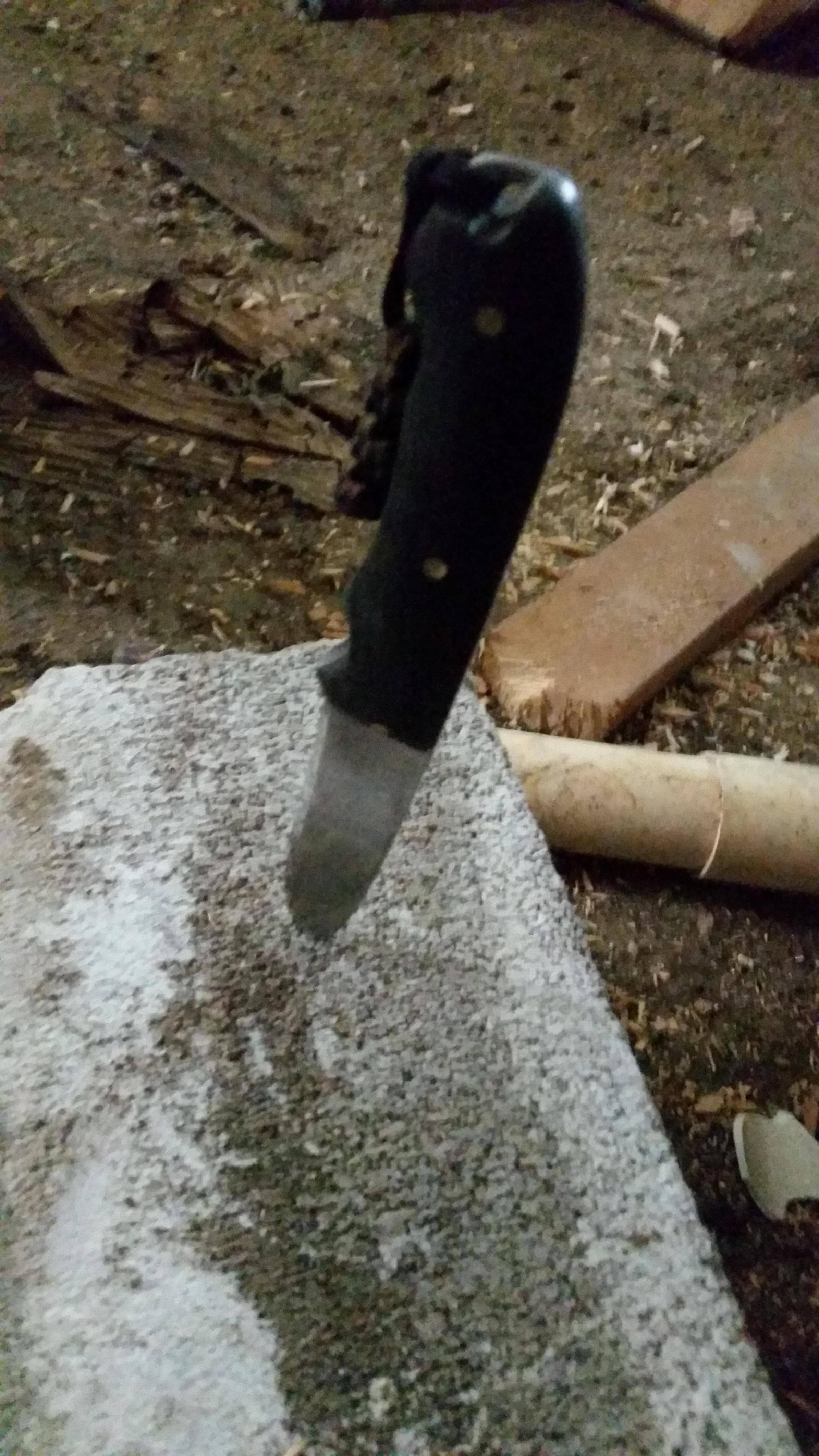

Same cinder block. The ZT performance on the left, Luong's knife's performance on the right. So far everything I've cut has been cut more cleanly and with more precision with Luong's knife.

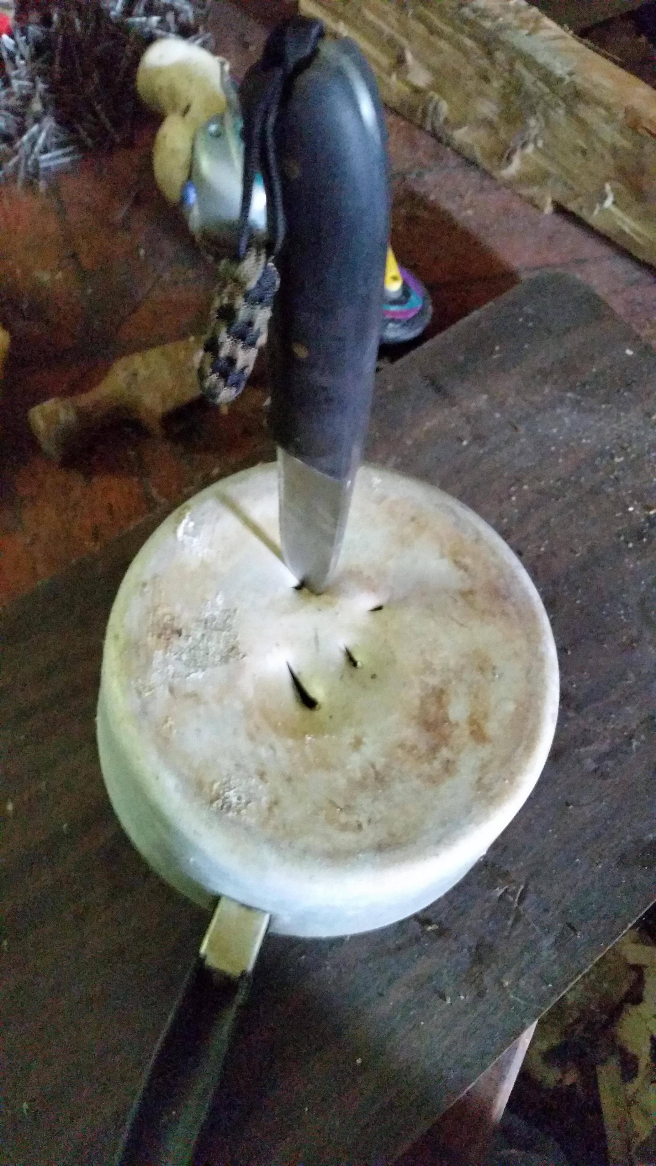

Same pot

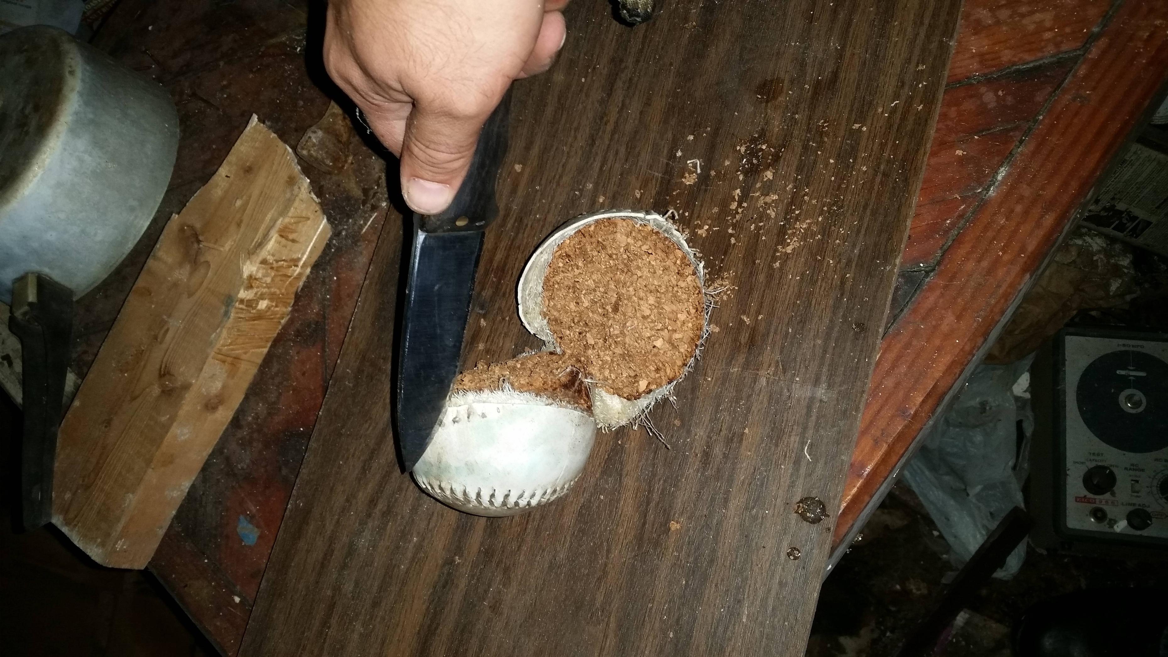

Surprisingly this softball was one of the hardest things to cut. First I had to hammer the blade through the core and then it got stuck. A knife with a softball stuck on it isn't any good so I had to beat the softball off. Then I had to baton through it with a piece of 2x4 (not the one shown). That ball did not want to give up the ghost but the knife eventually won.

I think matching Luong's super quenched 52100 to Vanadis 4E is hard. They're both equally capable of handling rough and dirty work. They're both hard, strong and tough. Where the Vanadis 4E chipped, the 52100 dented and rolled but didn't fracture. Vanadis 4E has higher wear resistance but at a significantly higher cost. There are tradeoffs and pros and cons with both.
I can more easily compare the two knives as whole packages. I think Luong's knife made of 52100 with his heat treatment giving 61 HRC is better than the ZT. The only reason it looks a little worse than the ZT is because Luong's knife is thinner behind the edge with a more acute edge angle. It did some really hard things with not a lot of material to support it at the edge.

I came in from the test and have been sharpening it for about an hour already. I took a break from that to post these pictures and my thoughts. Most of the damage, minus that one large dent, is already gone. Actually, most of the damage was gone in about 15 minutes.
I'll be back with how long it took to fully repair the edge and get it cleaned up.
