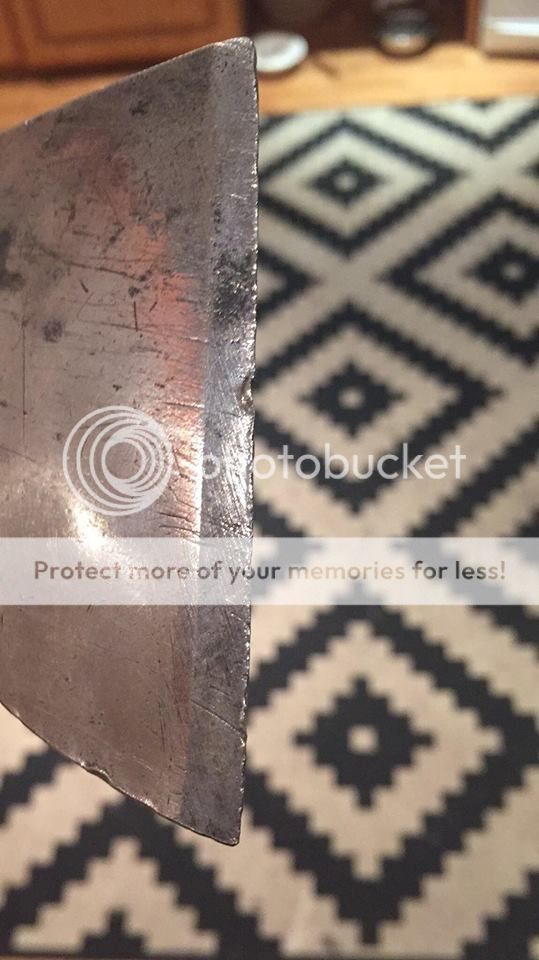

Bit of a Lurker here from Scotland. Loving this section of the forum and I purchased what was labeled as a Plumb Hatchet but now I have the hatchet shipped over from the US Im not sure what it is and any help would be appreciated.
ebay item number; 112271583775 and hopefully the link; http://www.ebay.co.uk/itm/112271583775?_trksid=p2057872.m2749.l2649&ssPageName=STRK:MEBIDX:IT
not sure how to add images here? But tonight I managed to get a nice hone on the edge, enough to slice paper. :)
Any help would be appreciated.

Here's the stamp on your half hatchet:
Here's a similar stamp on a cleaver:
(Plumb ANCHOR BRAND logo with EXTRA above it, and DAMASCUS STEEL below it)
Forum member Operator1975 spoke very highly of the steel and heat treatment of older Plumbs and your's definitely qualifies. After Yerkes retired the company went forward as Lafayette Plumb with the anchor symbol in 1887/88 and then the square-framed PLUMB logo appeared in around 1917, with patent granted in 1920. Your baby is at least 100 years old!

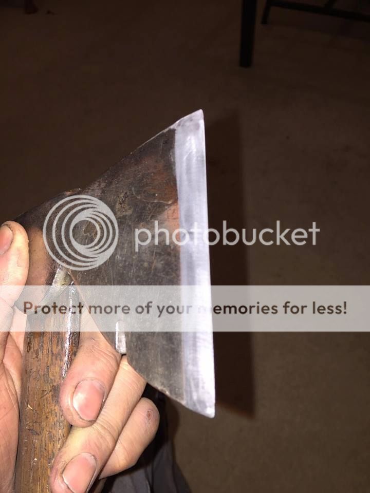

Gary3, I'll look into the oddity in the eye tonight, hopefully it will be ok but good to know it will take a small weld and a file.
Thank you for the info 300sux, great to know it's ago and I'll look at the links later when I get home. :)

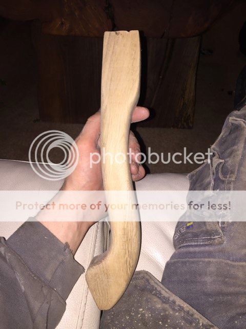

Well, I spent 4 hours honing the edge on my Japanese Water Stones and managed to get the dings and burrs out and got an edge that sliced through paper. I'm planning on replacing the shaft with a Viking one I'll make from Ash. I hve a 1000 year old Viking Hatchet replica I picked up in Norway as my template. Looking forward to that.
Managed to figure out the uploading. :D
Started on the shaft out of a bit of Oak Ive got. I'll make an ash one later.

Thank you for the kind words. :) it's my first time messing about with a vintage Hackett and the first time attempting a handle. Having a lot of fun and learning along the way. I've ground the face(if that is the correct word) to acutely so when using on the oak the cutting edge folded over a touch at one section. I'll have to regrind with more of a convex.
