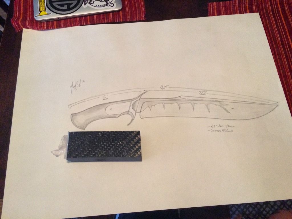

Its a commission for a fellow Forumite and I'm stoked to be working with him. His requests were simple.... BIG Bowie, carbon Fiber handle, and the tip pointing down.
so I drew up a sketch and sent it his direction. Once I got the green light it was time to light the forge!

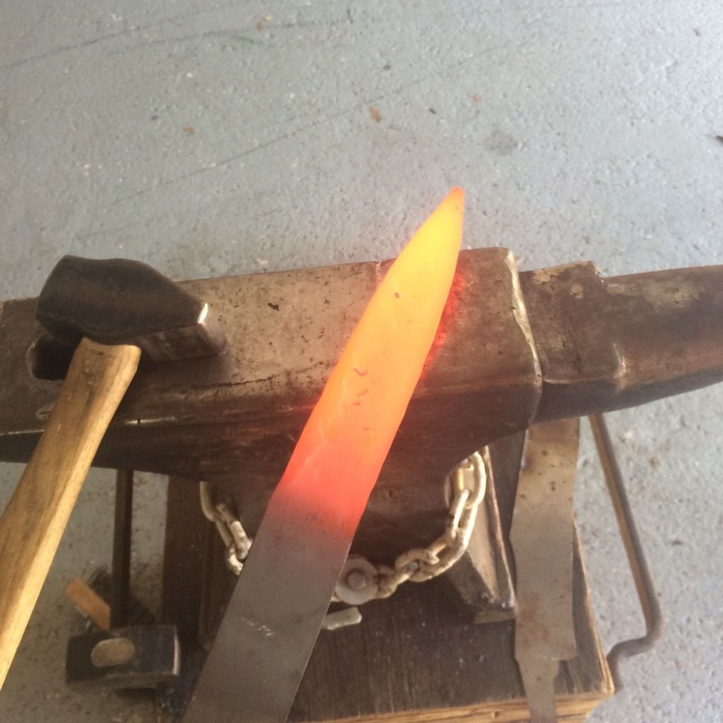

Starting things off with a .312" thick piece of W2 from Aldo over at the New Jersey Steel Baron.

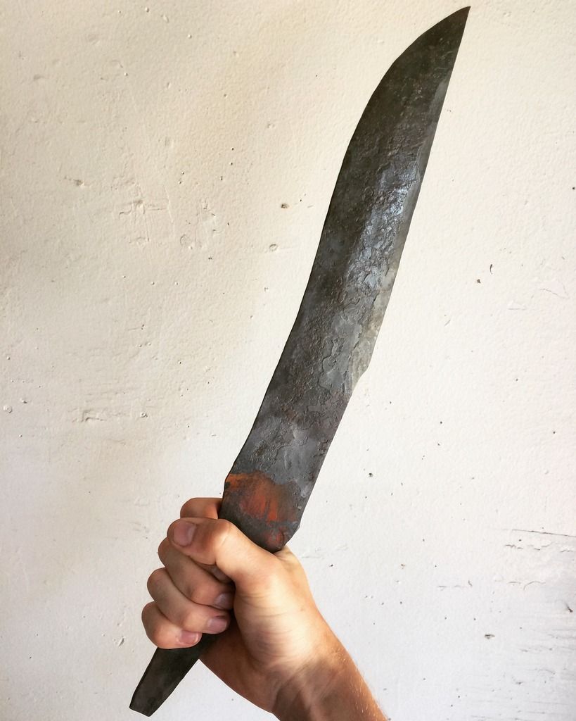

W2 likes to be forged on the higher end of the spectrum, and the first order of business was to knock the point in and get started on the distal taper. The taper is very important to me, as it is in all my blades, but being how this is a larger knife its particularly crucial to get it right.... or else the knife will handle like a pig on a shovel! :p:(

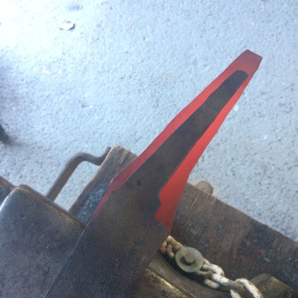

Stating to get the blade to shape.
I'm constantly checking my progress up against a mild steel template that i have cut out and handy.

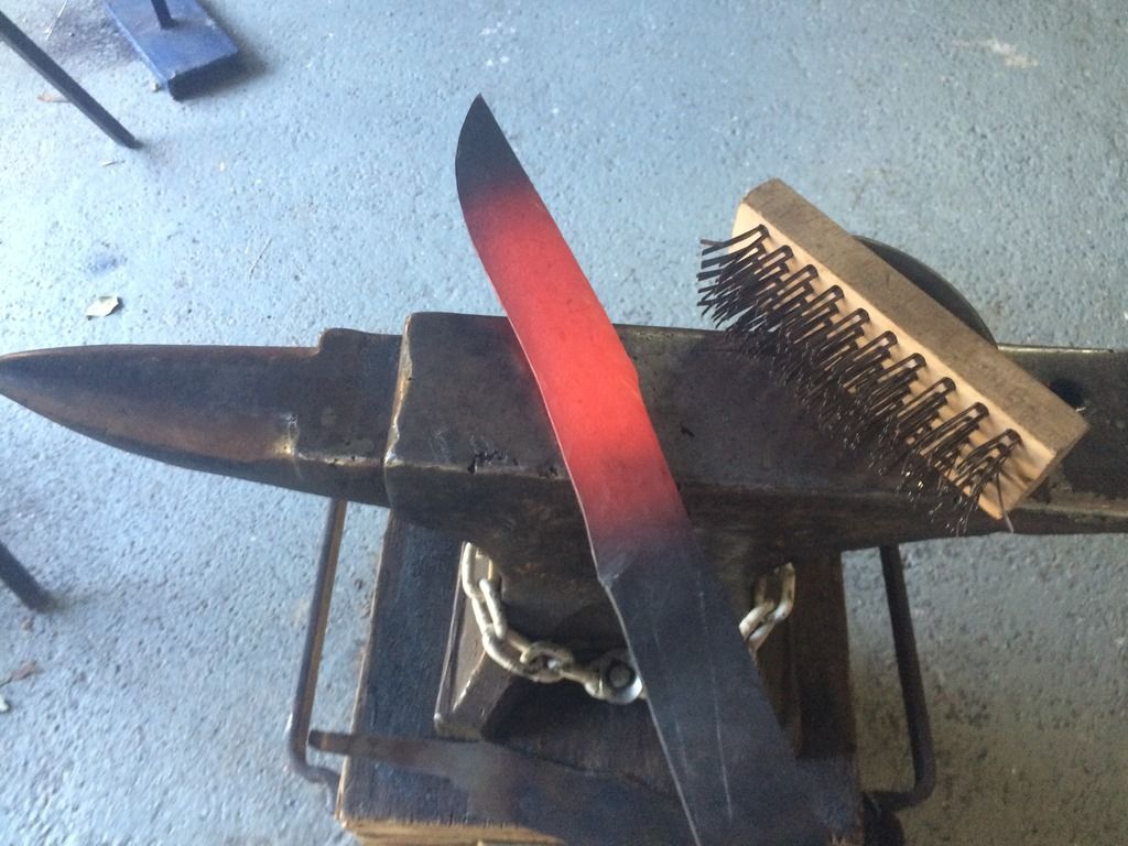

And here we have the forged blade! keeping the edge centered was really tough for me, as i don't have experience with blades this size. However, after a bit of tweaking i got it!

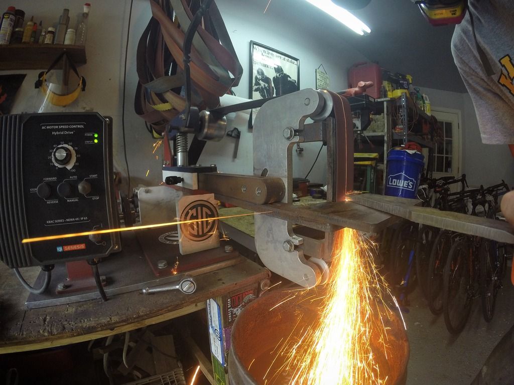

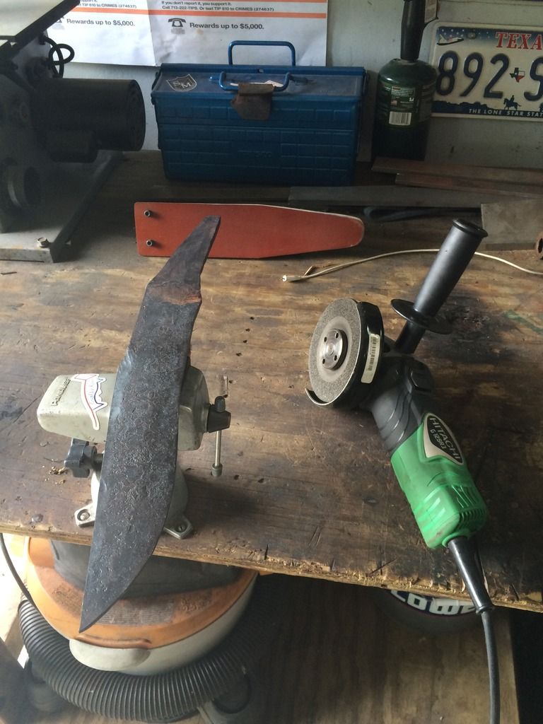

After the blade cooled down i went ahead and ground off the majority of the forge scale with an angle grinder. You can use vinegar etc... but aint nobody got time for that :p

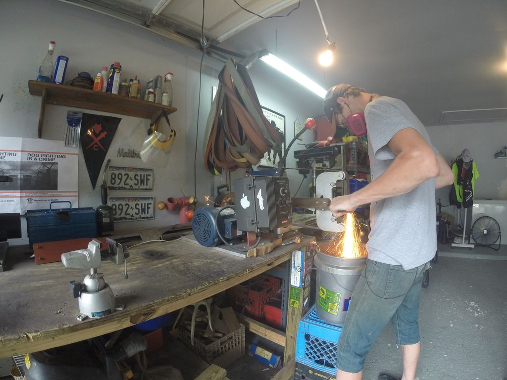

Now it was time to profile the blade. Always fun to take pictures of sparks! *Also why you should always wear eye protection fellas

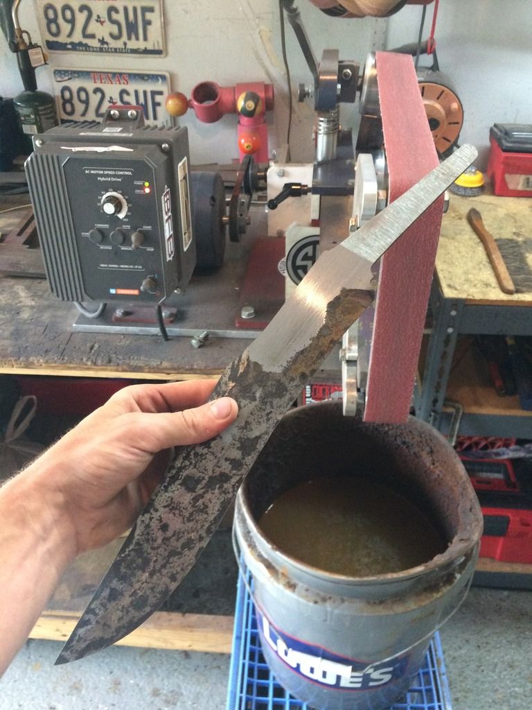

Now that the profile is cleaned up, it was time to establish my flats. I do this by hand with a 100# magnet up against my glass platen. I constantly check the ricasso on my surface plate as well as with a set of calipers to make sure everything is how it should be. Its's very important to get this area of a knife right as the rest of the knife builds off of this foundation.
Now I'm off grinding the bevels! Mwar Sparks!!!

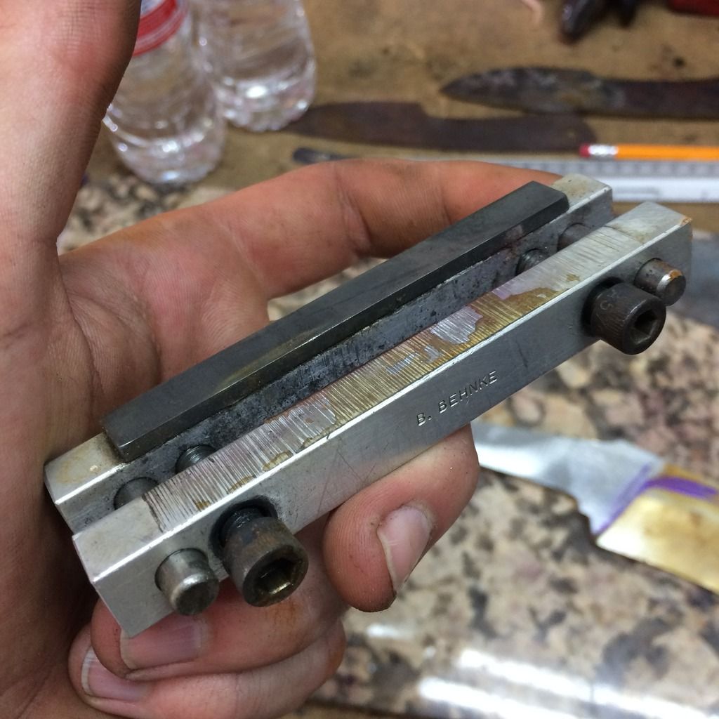

Heres a a progress shot. As you can see i use a carbide faced filed guide to ensure my plunges are even.
Aaaaaaaaaaand i broke it.... i can never have nice things :grumpy:
ill have to fix this later so i can fit my guard....

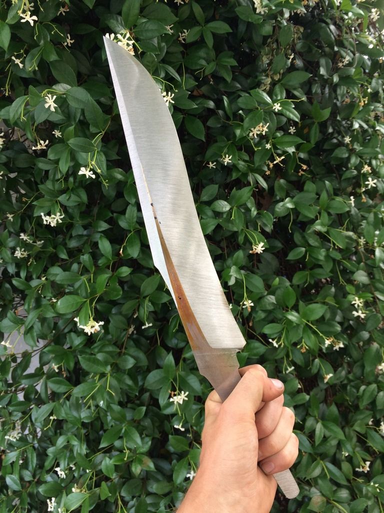

And Here is how she sits! completely rough ground and ready for HT sometime towards the end of the week. (I've got 2 remaining finals to take then I'm free!!!)
Oh, i also got the top clip ground in. Didn't get any pics of that. I ground it in same as the main bevel :)
My customer says he likes long Clips, so I'm hoping he likes this one!! its going to be fully sharp to boot :D
