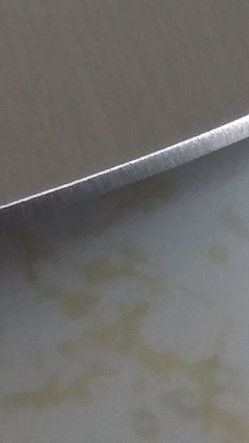

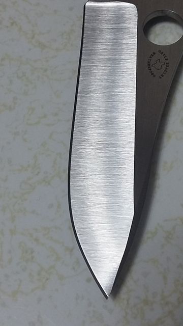

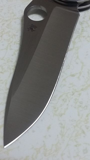

Hello all,
I'm new to the forum but a long time lurker. So I purchased a spyderco gale Bradley and the edge is not centered. I have a sharp maker and can get a bur on both sides but still the edge is almost straight up the left side when looking straight down the edge when pointed up. The right side is a major steep angle. I notice when I cut cardboard the edge doesn't last but maybe a whole box and then it's dull. I'm sure M4 should last longer than this. My question to you is will my wsko be enough to center the edge or should I send it to a professional like Jason or Josh?

Here are the pictures you emailed to me.
Hard to say for sure but from the first picture it appears that you still have factory grind marks in the bevel. Before anything can really be said those need to be removed and a complete scratch pattern of your own making must be applied. I would recommend diamond rods or a diamond stone to make the work go a little quicker. The Sharpmaker grits are rather fine and don't offer much in terms of stock removal.
Also, I've never seen a GB ground so thin which leads me to believe that your bevel angles are more obtuse that you think. Overall, you must remember that this is a machine ground factory edge and is by far one of the most inconsistent ways to make an even bevel. Too much steel is removed too quickly for any real precision. Typically, when I get a knife in for sharpening it takes several minutes on an 140 grit diamond plate to correct all the low spots, recurves, and angle inconsistencies that are so very typical of factory edge grinds.
Another way to check and see if a grind is off... look down at the tip from the spine side, and look at the grind at the heel from the edge side... pretty easy to see if the grind is off from these areas.

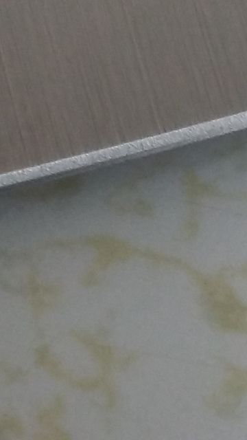

So if I lay my blue dmt against the rods what angle and what side should I do first? When I look from the tip down the left side of the tip is just a hair and I mean hair longer than the right. I can hit the left side with the 15° slots and shoulder on the right side. Hit the edge on 20 with the right side and hit the edge on left with 20. As seen in the 4th picture. Would I work on the left side at 15 or 20 and then hit the right side at the same or would 15 make my right side bevel a lot larger than left? Thanks for replies guys!
It's less about what side you start on and more about how much you inspect the edge while sharpening. Once you get a bevel going with the coarse stone you can begin to inspect your work after every few strokes, look at it from all angles and gauge how much work needs to be done on any one side. Truthfully, this should be habit for any stage of the sharpening.
As you get closer and closer to getting the bevel centered spend less and less time on each side until you are basically just making one stroke per side.
As for angle, always go as low as possible. Obtuse edge angles do absolutely nothing for cutting.
