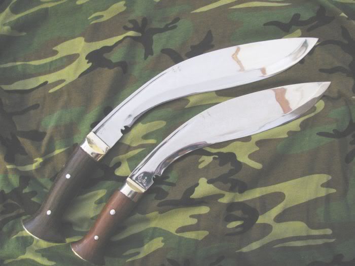

Since Wildmike keeps bringing up how much livlier his M43 is than an Ang Khola, and also mentions a thinner edge and spine, I have a question:
Did one of the Kamis make a thicker one?
Mine has a 1/2" spine, and the edge is about the same on my CAK (which, admittedly, is a Bura and I think he put a finer edge than is normal on CAKs)?
Also, putting them side by side, I have a CAK by Vim(?), the Bura CAK which is my favorite and my M43.
The Bura CAK has about 3/4" more drop at the tip than the other CAK (both 20"), and if I extrapolate the spine of the M43 to 20", the M43 would have roughly 5/8" more drop than the Bura CAK.
So, for the M43 experts, is the reason the M43 didn't impress me as much as others are with it because it doesn't weigh much less with the 1/2" spine, and isn't dropped as much in relation to the Bura CAK as it would be to a more standard CAK?
I'm starting to think I got incredibly lucky with the Bura -- the perfect kuk storm so to speak.
My M43 is considerably thicker and heavier than a standard M43. It still somehow has a more lively feel than an Ang Khola of the same length.

OK, I had to break out the calipers.
The Spine is:
M43: .475"
CAK: .520"
The "height" of the bevel (from blade toward spine:
M43: .590"
CAK: .590"
Width at top of bevel:
M43: .218"
CAK: .222"
So it's no wonder, with more length, a bit more weight, and roughly identical edge geometry and spine thickness, the CAK outdoes the M43. A 20" M43 with the same geometry would probably give it a real run for its money. As it is, the 18" M43 rose to be my #2 pick very quickly.

My Bura made M-43 is of the traditional weight and size of the M-43 (Mk II) it weighs in at 26 oz.
My new style (unknown Kami) is of about the same size. with about 1/2 inch more handle and a thicker spine. It weighs in at 29 oz.
Not really much of a difference.

Wolf_1989,
How thick is the spine of your Super CAK? weight-wise, on the scale, how does it compared to your heavier M-43?
Super CAK:
OAL 20.25"
.354" thick
34.45 oz
M43:
OAL 20"
0.5" thick
41 oz
So you feel the bevel of the Super CAK or the weight by itself contribute to a better chopping than say, your heavier M-43 ?
Their chopping abilities are pretty close. The SCAK has more slicing effect while the heavier M43 has more percussion.
With a lighter feel, Super CAK in a way that chops like butcher but still swing like Chitlangi?
The Super CAK handles like a well made and well balanced short sword. That's what makes it 'super'. It's a BIG, powerful khukri but it's amazingly light and nimble. I suspect Sgt Khadka was secretly trained by Himalayan Elves.
I'm thinking of Cpl Punishment's 20" CAK that chops well but still nimble enough to slice things nicely. Scary sharp edge?
It's a big curved scalpel.
Your M-43 must be amazing in a 26 ounce package. My M-43, as nice and nimble as it is, still comes in at a hefty 35 ounces. I'm not the biggest person around either, and can't control it too well, at least not with one hand. Must speak with Auntie when I have the spare funds.
I'm surprised at the weight of Wolf's 41 oz. M-43 course it is a 20"er.
My weights could be off as all I have to weigh the knives with is a digital fish scale.
