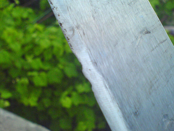

My Tramontina done the job, but the edge rolled.
