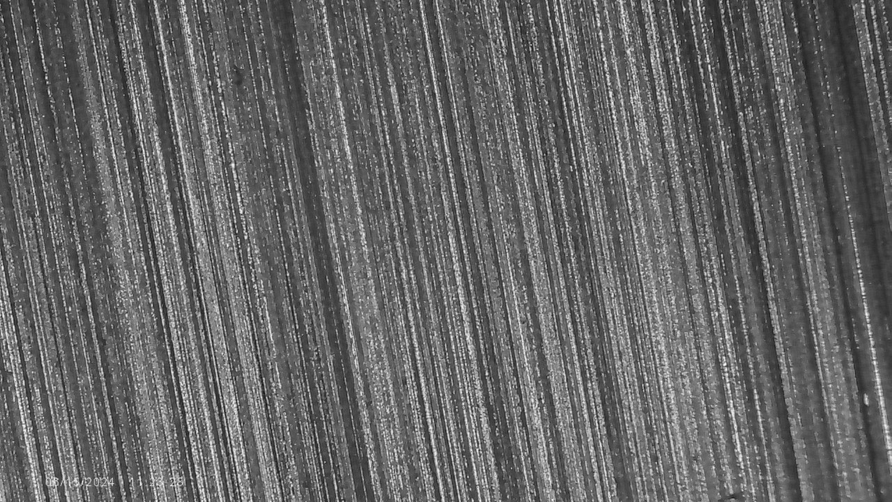

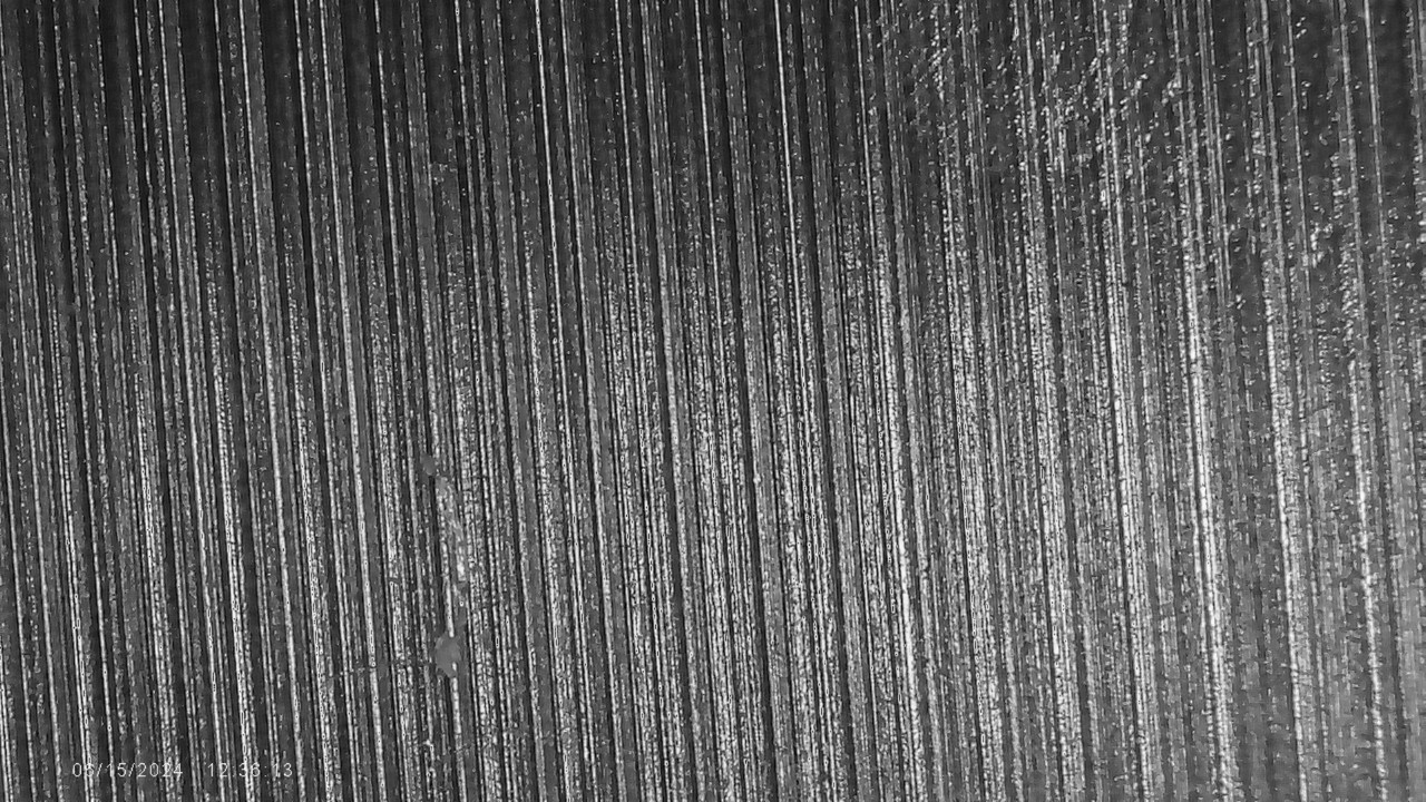

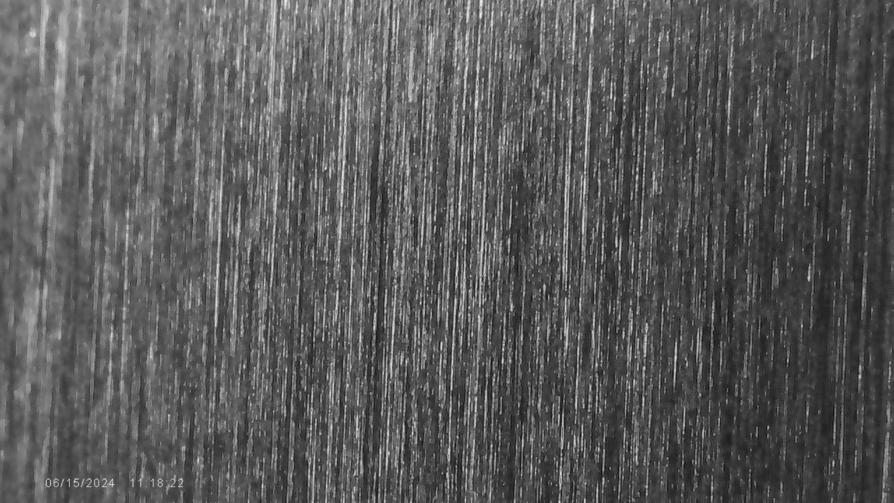

IDK, but I prefer the fine lines on my blade to go the long way.
view
