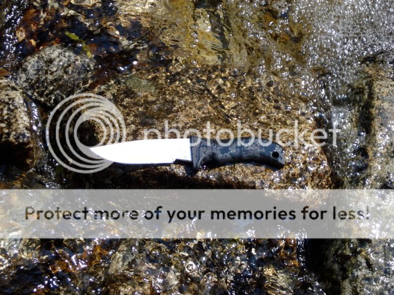

I had the 1/4" version and I really did like the knife overall, but 3/16" would make much more sense for that size knife. I guess it really depends on what you want to use it for though. I did use mine quite a bit and even took it on a backpacking trip in the Sierras. The handle is one of the best I have ever felt.
I had the hard chrome finish
