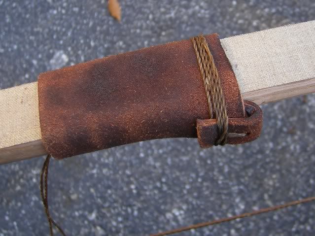

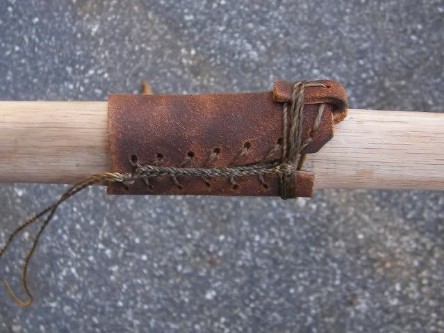

There have been a few primitive/traditional archery threads coming up lately and its made me want to make a few bows for my friends. I finished this today. It is a linen backed red oak longbow.

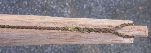

The bow is 48lbs at 26in with a flemish braid string made out of eight strands of artificial sinew. I still have to serve the string and sand out one small nick above the handle on the belly. It shoots very fast. I'm going to heat it tomorrow and try to deflex/reflex the limbs. I don't want it to turn into a reflex bow so I'll have to be aggressive on the deflex part. The handle and rest are deer leather. The bow has 20 shots through it. There would have been more but it was getting dark. I'll put 150-200 shots through it tomorrow and break it in properly. After that I will put it through my chronograph with cane arrows to see how fast it shoots.
heating it now will un_adhesive your back's glue; mor'n likely
I know, that's why I haven't made up my mind about doing it. These bows are give aways so I don't want to back it twice, to much effort. That said, the other reason I considered it was that I decided I don't like the look of the linen backing so I may remove it and back it with rawhide. I think rawhide backed bows look very nice but this one is four inches longer than my longest rawhide backing piece. I also have three more bows to make as gifts so I may leave this one as is.
