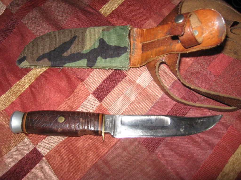

My first effort. From a piece of broken file.
Why the paracord?. riuned 2 sets of scales tring to peen, an as yet unmastered skill.
advice, criticism,and comments welcome

As for the knife, well, to be honest I think it's ugly. Given your posts, I'm assuming here that you'd prefer honesty to silence. And really, what your knife looks like is not the point- you need some good pats on the back to help you stick with it. That's worked wonders for me!
But hell man, it's your first knife! If you truly love doing this kind of work, there will be a second, then a third, then a fourth,...:) They will get better and better and better.
Keep at it ! It gets easier and more fun/addicting.
AS far as peening it,s NOT necessary. Drill your holes in the steel and handle material, use a file to notch the pin a few times where it will be inside the scales ( Unseen ) and epoxy the whole thing together.

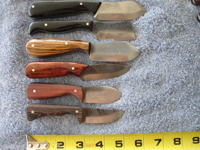

# 2 in progress - got the jones bad. retired and slightly diabled so I work slow.

First knives are AWESOME no matter the shape or finish. Put that thing on a shelf and make sure its somewhere you walk by and see it everyday!!! You'll understand my motives in a few months. Good luck and keep up the good work, feel free to email me if you need some reference (parts, techniques, tools, I'm no Blackwood or Wilson, but I do know them)
I 've never made one with a file. How do you guys cut the file without wrecking everything you use to do it? Do you soften it up first or just go to it?
Thanks Frank.
Stax, Anneal it soft, I threw this on in a burn barrel and let it cool overnight.. then work it.
Heat treat and clean it up, then temper.
Presto, ugly knife!
