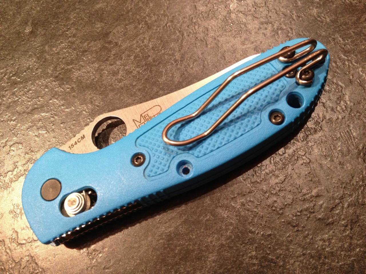

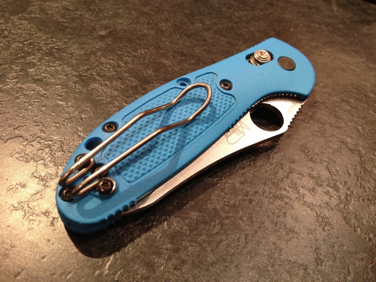

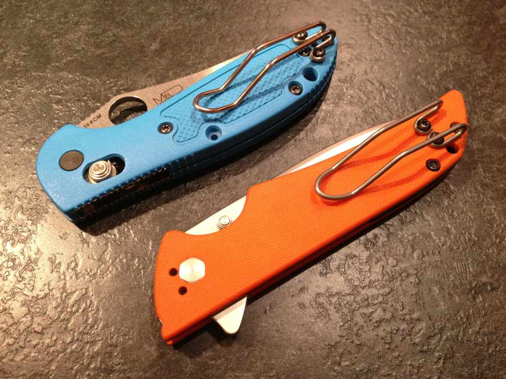

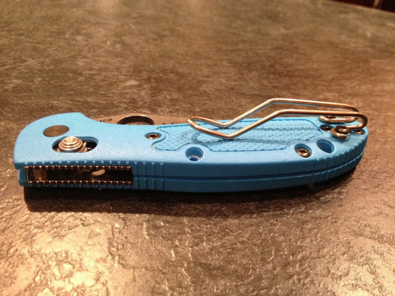

Made myself a deep carry wire clip for my Mini Griptilian
Jun 2, 2011
46
I love the wire clip on my Sypderco Pingo and Dragonfly2 so I made my own for my Benchmade & Kershaw since neither came with a deep carry pocket clip:
And with my Kershaw Skyline:
What gauge is the wire and what tools did you use to form the clip? Nice looking job.
These are 17 guage 304 high tensile stainless steel. I heat and bend these by hand then throw them into a container with stones and into the dryer for tumbling :)
Looks great. Just wondering if the screws are stock or new longer ones. If they are stock I'm not sure if there is enough length.

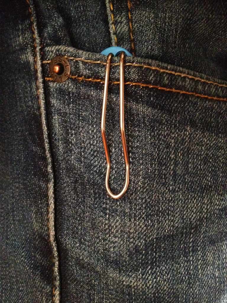

Those look great. I really like wire clips. They're not as noticeable, and they slide into the pocket very well.
