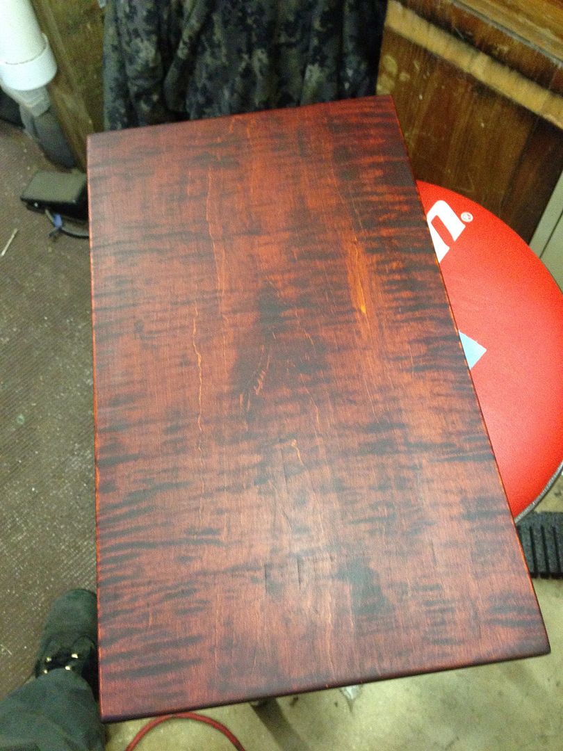

So in order to have somewhere to store my custom kitchen knives, I decided I wanted to make a nice magnetic knife rack.
I started with a really nice curly piece of maple and went from there.

All stained up and oiled!
