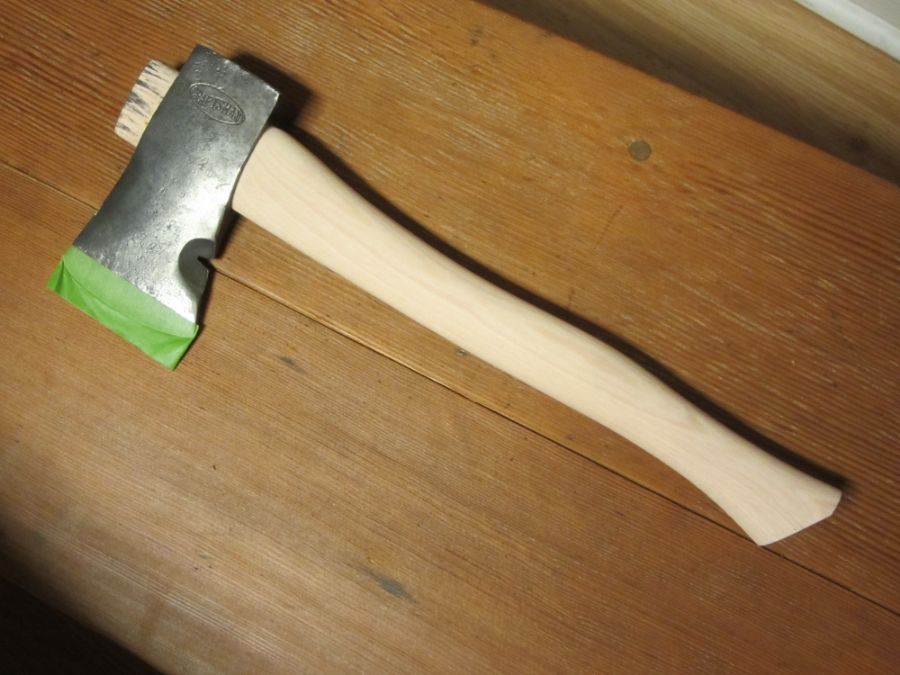

I gave my boy this Craftsman hatchet for his 10th birthday. It arrived just in time for his birthday without a haft. I have managed to sharpen it but it has been waiting patiently for a new haft. I decided to use some madrona for the haft so I broke out the hewing hatchets and this piece of madrona that looked good and went to town.
After hewing and carving for a couple hours I shaped it and fit the eye with the little sureform.
The cabinet scraper and a little sandpaper finished it off and now its ready for the kerf and to be hung. At 14 inches overall I think this will be a good little hatchet for him.

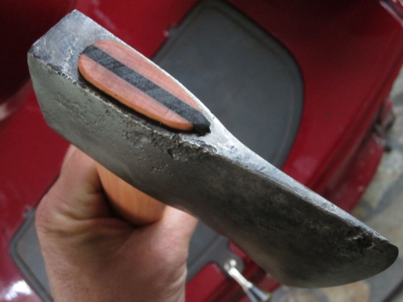

The wedge got cleaned up.

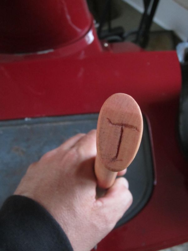

I carved a "T" (my son's first initial) in the end of the haft.

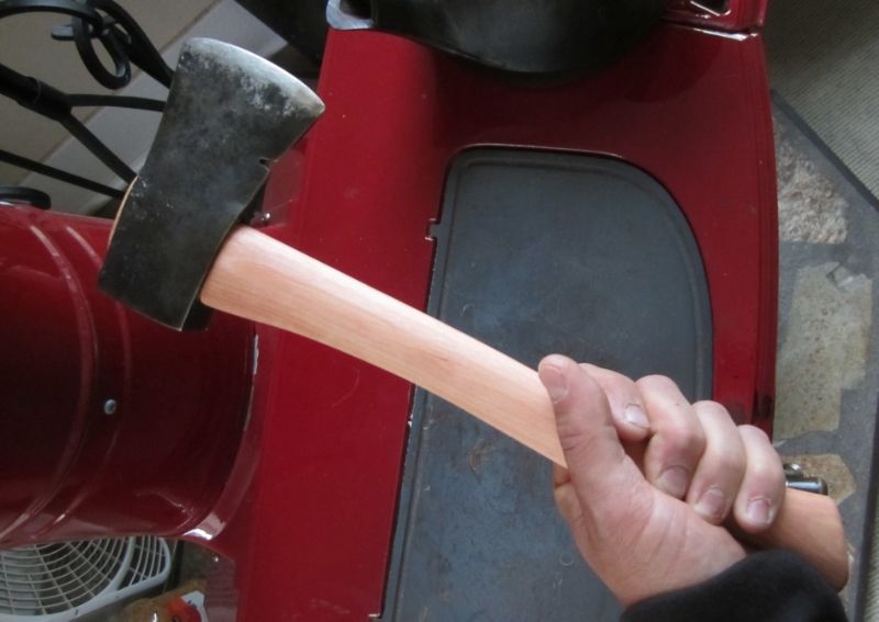

The haft feels a little thin in the grip with not as much swell as I like at the knob. I think it should be good for a 10 year old though. I might drill a hole and add a leather strap to it so he can loop it around his wrist and hang the hatchet from a hook or something when not in use. I am a little concerned about the stability of this wood.
I am pretty happy with how it turned out so far and how the BLO really brought out the color of the wood.
I will probably put a couple more coats of BLO on it and then maybe some tung oil depending on how it feels once the final coat of BLO has dried.

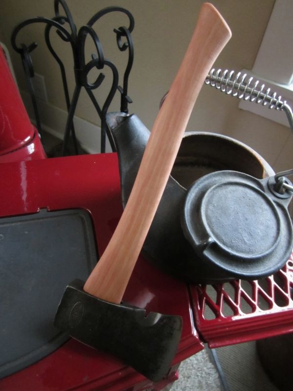

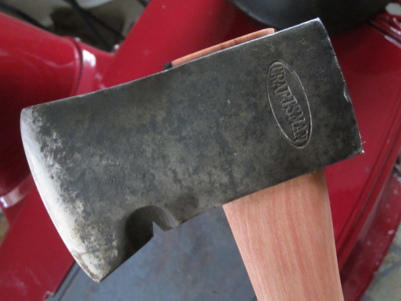

So yeah, wanted to say that the piece of wood that I shaped that haft from was a two foot long piece I got from the very base of a windfall from this winter. It had a lot of color in it when I split it. Anyway, for some reason it wouldn't let me reply with much more than I was able to in the last post. So, here are a couple more pics of the finished hatchet.
That looks awesome, especially with the stamp.
And please remember if your son loses his grip (thin hatchet handle + ten year old hands) then a lanyard would create a swinging arc of sharp steel.
That swinging arc might hit his arm but it's unlikely to hit his sister's head.
Jus sayin'.
When you made the handle did you have a pattern, freehand it, or go off of another handle that you had?
I had an old 18" haft that I used as a very rough pattern that needed to be blended into a shorter outline. Once I got the rough shape I could see better what the grain was going to allow and then freehanded the final shape and thickness to what looked and felt good. Its actually quite a bit thinner and straighter than that older haft.
