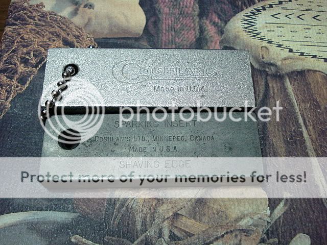

So on New Year's Eve, I managed to stop in at MEC and pick one up. This is the bar in question. Reasonably priced, and a good tool if my experience in the past was any indication, but that remained to be seen.

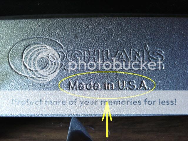

A quick look on the back, and......wait, what's this?
Must be some kind of mistake. Why would any company advertise an item made in the USA as being made in China? Some kind of reverse snobbery? So I removed the bar to check it out. Son of a gun! :eek:
Obviously somebody made a mistake. I checked two other mag bars, while still in the store, and they all said the same thing.
No matter, in fact this might even work out better - a comparison between the new mag bar, made in the USA, and an old one, made in the USA, purchased a couple years before the invention of electricity. :( Hopefully, this will show whether the newer ones suffer from decreased performance.
more to follow
You notice how both bars identify themselves a being made in the USA? Quite awhile back, I believe it was Normark who confirmed that Coghlan's were made by Doan. Maybe he will make his bi-yearly appearance here and confirm it, or perhaps a paying member can do a search and find the thread. It also stands to reason, that Coghlan's made in the USA, would be so close in appearance to Doan that it would violate some kind of patent law.

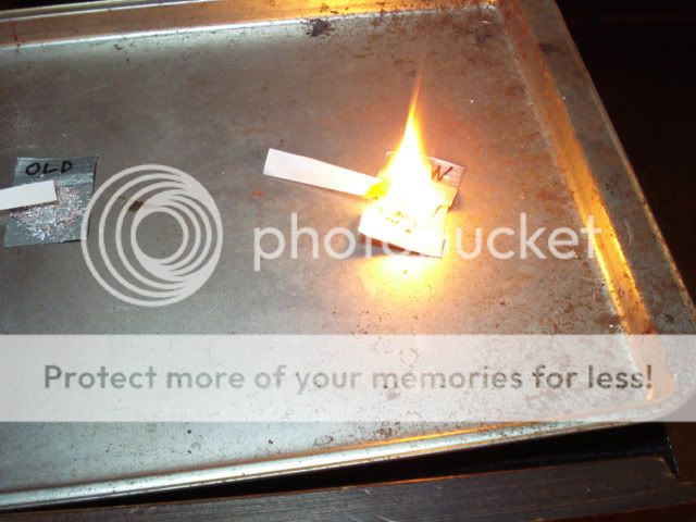

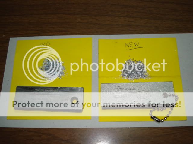

Anyway, on to the test. I left the chain on the new bar to make it easier to differentiate. My old bar was pretty corroded, so I decided to be fair, I would scrape both bars down to fresh material, beneath the surface. Once done, I would make a 'quarter' size pile of scrapings.
I was going to count how many strokes, each bar took to make the pile, but soon gave that up. As close as I can tell, both bars are equal in hardness and took the same time to make similar sized piles of scrapings, I'm guessing 30 - 40 seconds, using a knife blade.
I took a small strip of printer paper and folded it in half lengthwise, to raise the paper off the surface of the metal sheet (I got impatient to do this, so did it in my apartment, rather than waiting to the morning, to do it outside) and placed it half covering the magnesium piles.

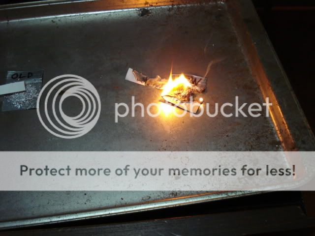

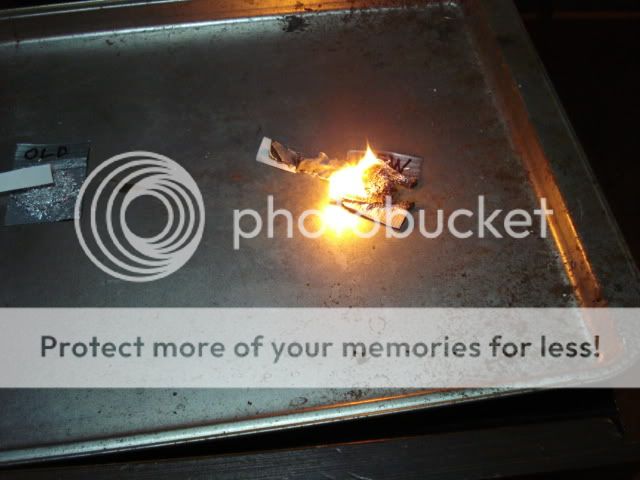

Two strokes of the ferro rod of the new bar, resulted in ignition, which immediately set the paper on fire.
I see no problem with this new bar, at all.

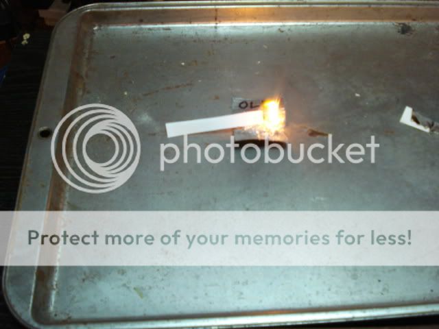

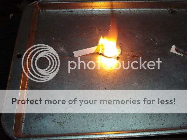

The old bar? Three strokes!
The results show me that there is virtually no difference between the old and new mag bars (at least the one I tested) and they both worked flawlessly.
My take is that the mag bar will successfully light less than optimal tinder, whether type of material or dampness, and will continue to be an important part of my kit.
