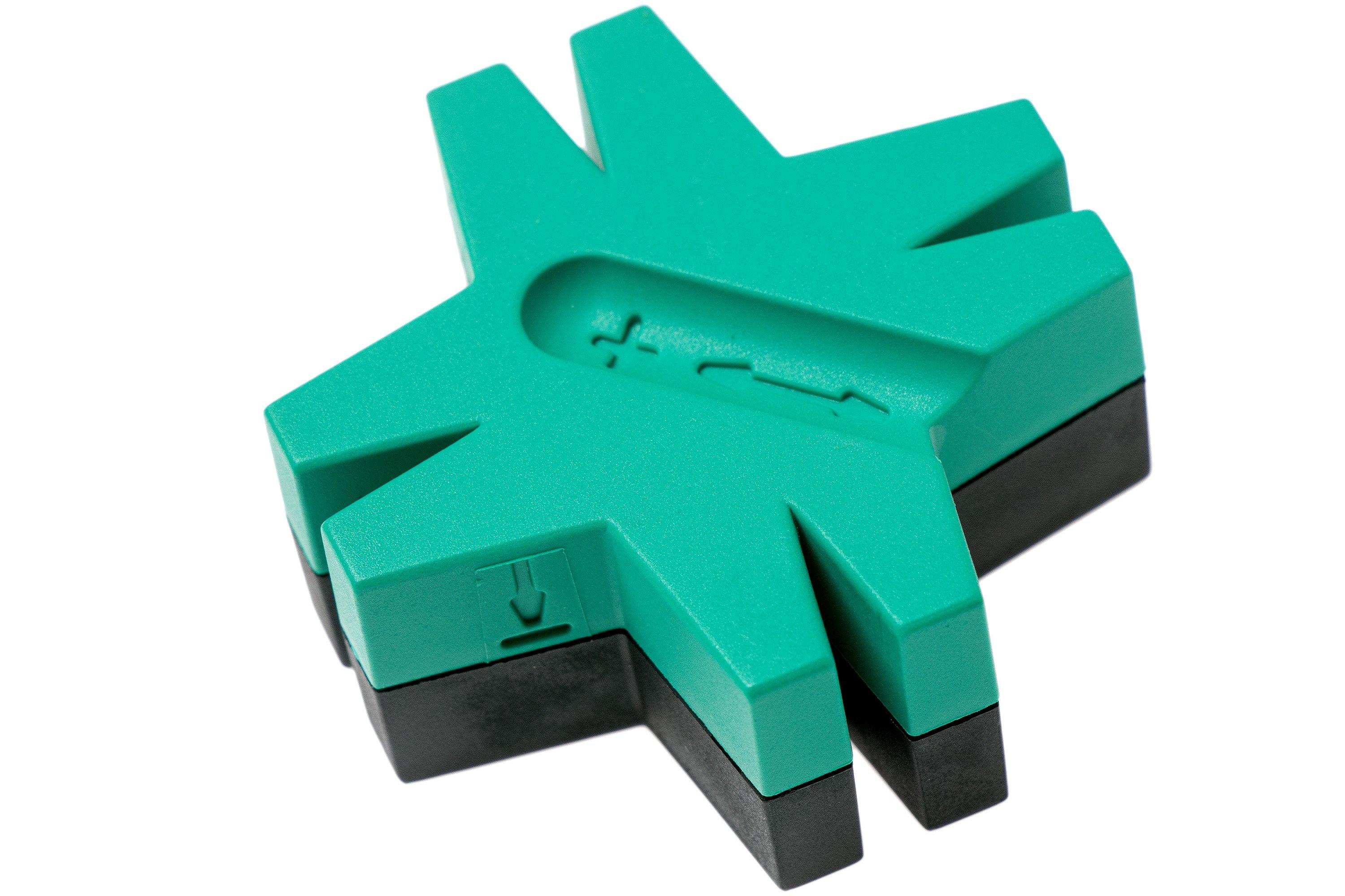

I have a small device which will magnetize/demagnetize a tool, with just a few strokes. Sometimes useful for magnetizing a screwdriver. However, I haven't checked my knives, I just came across the one above by chance! :D

This is the little magnetiser/de-magnetiser I have. Made by Wera :thumbsup:
WO5073403001_02_wera
It's about 2" across.
