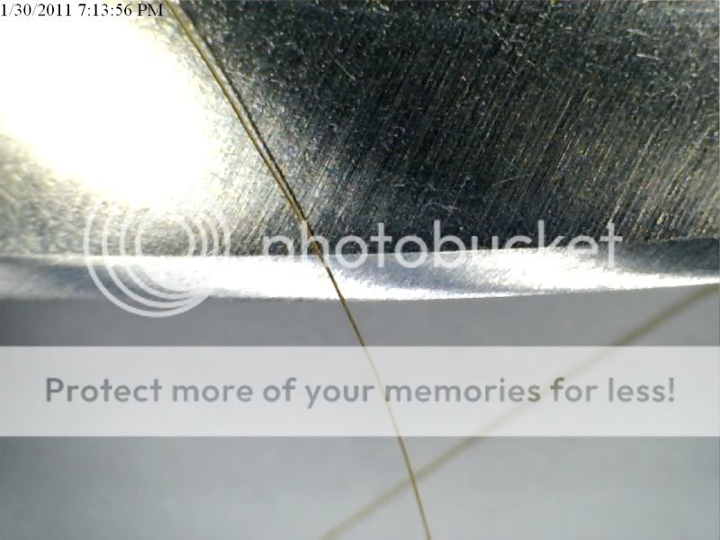

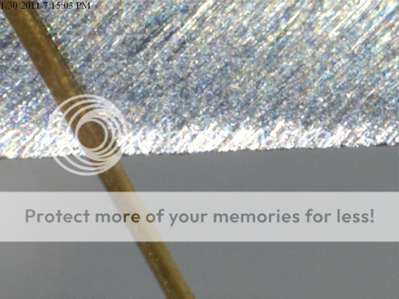

I have a veho vms-004. My scope is variable between 20x-400x. you'll basically get two focuses out of it, low powered 30x-50x and high powered 350x-375x (these are estimates based on where I think the variable adjuster is). I have used it to take a lot of pics of knife edges, and it works pretty well for me.
Here are two pics to show you low and high powered focuses.
Low, about 30x-50x. This is a thin strand of hair from my daughters hair brush:
High, about 375x:
