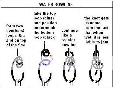

Another specialty Bowline, I guess you could say, is the Water Bowline. Its claim to fame is it's less likely to jam when it's wet, say when using it around canoes, etc.

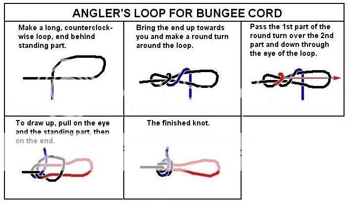

And the last end loop I want to mention is for our troublesome friend, Bungee cord. This knot is called the Angler Loop or Perfection Loop.

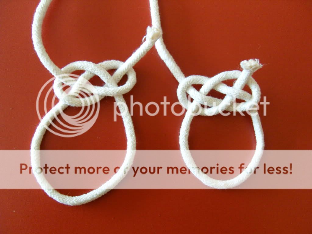

Doc,
Here's on left the Carrick loop as described by Ashley (#1033) and on right the knot as i'm used to do it:
You have noticed the similarity of the #1033 with the bowline and for me it differs from the "true" Carrick, i would even say that it's more of a bowline than of a Carrick. By the way, Ashley himself in his comments, says that #1033 is made like a "wrong" Carrick knot.
The bowline and the Carrick are two very different knots and it's amazing to find with the #1033 a meeting point. In my opinion the two loops perform both very well. I keep on making it this way because the Carrick is a bit tricky and i want to remember the right way to make it. Any variation in it's structure decreases drastically the reliability of this particular knot. From #1040 to #1045 Ashley is very critical with the so said Carrick knots.
It may sound a bit rigid isn't ? But you will agree: knot making is a serious thing.

You have noticed the similarity of the #1033 with the bowline and for me it differs from the "true" Carrick, i would even say that it's more of a bowline than of a Carrick. By the way, Ashley himself in his comments, says that #1033 is made like a "wrong" Carrick knot. Lol, in my version, it says, "The CARRICK LOOP has the same formation as one of the so-called single CARRICK BENDS. It is easy to untie, but it has no advantages over others that are simpler."
Nice picture, thank you for that. I have copied it to my desktop so I can play with it a bit.
The bowline and the Carrick are two very different knots and it's amazing to find with the #1033 a meeting point. In my opinion the two loops perform both very well. I keep on making it this way because the Carrick is a bit tricky and i want to remember the right way to make it. Any variation in it's structure decreases drastically the reliability of this particular knot. From #1040 to #1045 Ashley is very critical with the so said Carrick knots. Not so in my version. I should mention that mine is the Ashley Book of Knots, put out by Coles, but I don't think there's any difference compared to the non-Coles version. I learned the Carrick Bend a long time ago, and have practiced it for a long time, so, basically, I just let my hands do it - I guess it's a muscle memory kind of thing.
It may sound a bit rigid isn't ? But you will agree: knot making is a serious thing. Serious, yes, but fun and interesting too! :thumbup:

Got it! So you make the first loop exactly the way Ashley (and I) make the Carrick Bend (leaving a longer than normal working end), but instead of tying in the second cord, you use the working end as the second cord.
I find it more awkward to tie than the 'Bowline' version, so far, but that may change with practice.
Doc
Exactly!
Since yesterday i've made several times the two versions and i now wonder if i don't have put a useless complication in the making. It's good to try but simpler is always better.
