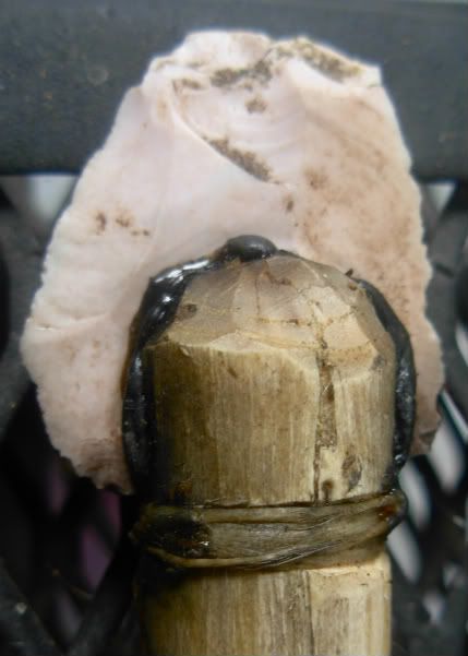

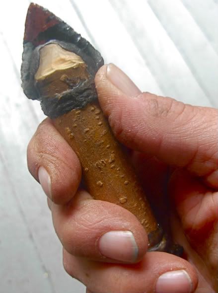

basic, very primitive, ugly but quite functional
been wanting to make a few of these since watching daniels vid on youtube
http://www.youtube.com/user/gotrocksinhead#p/u/26/BrEdJEwfcQs
still not a knapper tho i can knock off a sharp sliver pretty efficiently most days.
and thats all thats really needed for a knife like this. a sharp sliver.
my understanding of ancient native ways is that tho many were quite capable of making stone tools that were works of art,
often it was simply a matter of need at the moment.
and often these sorta tools were left behind when the task was complete.
bladesmith ed fowler tells a story about a large boulder he came across in wyoming, near his ranch, that was used thus.
many pieces had been broken off over who knows how many decades or centuries.
the flaked bits were left where they fell.
and for miles around he would find the tools made from this rock. used and discarded.
i didnt knap either of these. one is an obsidian point i did a trade for some time ago.
the other an old na native chert/flint piece found on the family farm.
both are quite sharp and capable of many tasks.
dont think there would be any problem using either to skin out an animal.
i have used just such pieces for that before.
having em hafted to a crude handle makes the job a bit easier and less likely to cut yourself while using it.

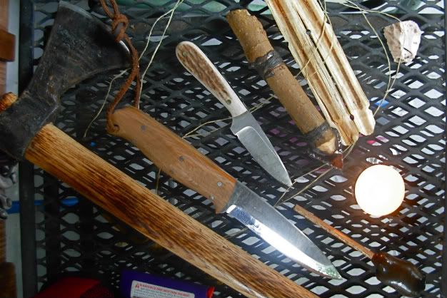

did use modern tools today sitting on the back porch.
a hawk to cut a branch of mulberry, a small blind horse knives necker to shape n whittle.
artificial sinew.
a pitch stick already on hand.
and the tea candle(which i lit with a bic)
this could all be done with no modern tools in a survival situation as long as you had some raw materials in your area.
and the basic knowledge of what you wanna do and need
once you knocked off a nice sharp piece of stone, the rest is doable.
cordage like was done for the recent contest could be used to haft the piece of stone.
if you can flake off a good sharp sliver thats all you really need,
but the handle does make working easier and safer

Nice job: by bringing your handle forward onto the stone you have supported the fragile stone and made the tool stronger. I believe that Folsom and Clovis knives were made this way with long flutes for the very reason you so beautifully illustrate. While they would have used other adhesives the idea is the same. Thanks for posting up your work and remembering mine.

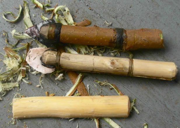

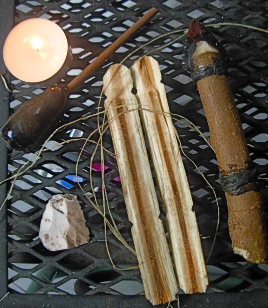

ok so it became apparent that i needed to make one of the handle bits with a raw piece of stone.
so here's what i did after posting last nite.
used the thicker longer piece of stone to score a mulberry branch twice and just break off.
the thinnest for splitting with a small baton(thankfully mulberry splits very easily)
and the rest with each of the tools. also used a big piece of rock in the yard to "sand" with.
you will notice the red from using a piece of ok sandstone.
but i made more powder than removed wood so didnt use it long(it's great for making pigment tho).
didnt complete a knife, wanted to make this handle with the stone bits just so i knew i could.
btw these are just three bits of flaked stone found on what i believe to be a village site.
have found numerous other tools there more recognizable as such.
but i believe these "shards" were used and once again, often discarded.
