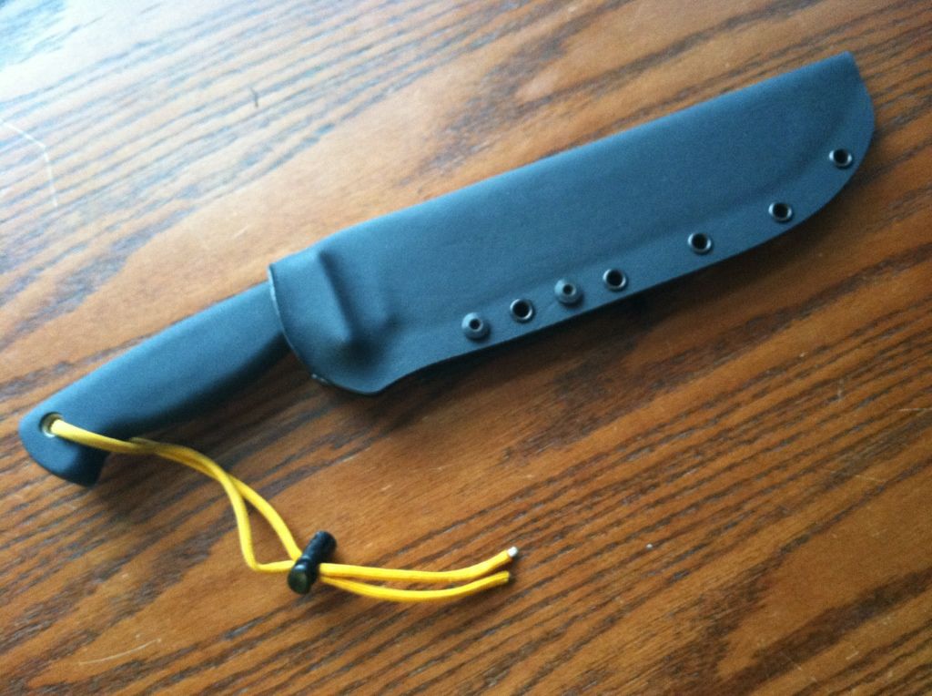

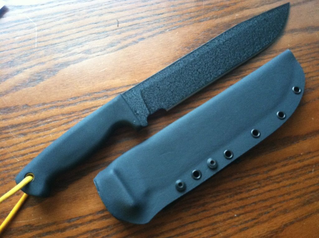

Insert the knife while the opening is still soft (but not too hot to hold) and just press in a bit above the guard. Just a little. Hold the pressure until it starts to harden back up. It should lock right in while still being able to be drawn.
Success! Thanks for the tip Kiah, that did it. I'll edit this post with a pic. It's not the most beautiful sheath ever, but it works very well.
