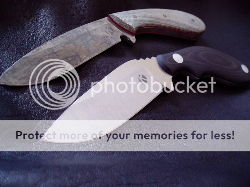

I apply a forced patina to high carbon blades. I just apply some mayo, mustard, vinegar, whatever on the blade and let it set a little while. I've read that once the patina is there, the steel is protected from further rust. I don't know if that's true but it has worked for me.
Here's a pic of a couple of Dan Koster's knives. The knife on the left is a carbon steel Karda with the patina I spoke of. Purdy huh?
