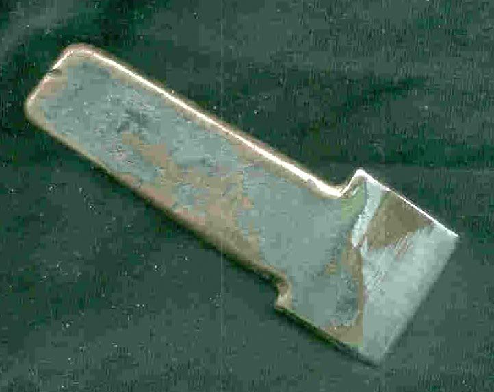

I make my hotcut hardies from one piece of flat steel, usually around 1/4" or so, and I forge it to fit diagonally actoss the hardy hole. It's alot easier then trying to attach or forge in a square shank, and I haven't had any problems with it yet. Here's a pic of my old one, my new one has a wider cutting edge but I don't have a pic.
http://img.photobucket.com/albums/v236/AwP_pics/hotcutter.jpg
AwP,
That is a very innovative idea! Do you mind if I borrow it? I can't believe I haven't thought of that before. It would be much easier than trying to upset and forge a 1" square out of 1" round stock. Thanks for the info. and pic.!
Todd
Borrow away, so many things I do are borrowed ideas anyway... that's what forums like this are for.
