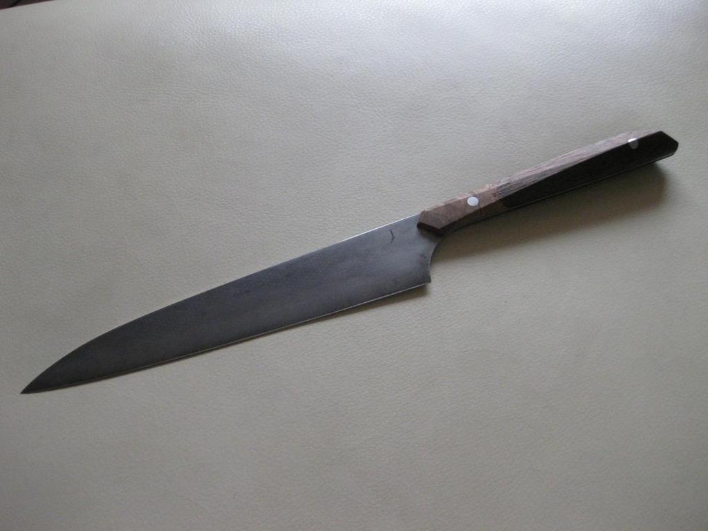

I'd love to see the history of what you guys have made throughout the years. I'm a new maker, so I have no idea what my stuff will look like down the road, but my current style is something I picked up right off the bat.
This is my 4th knife overall, about 2.5 years ago:
And currently:

i can see the roots of your style in that first piece, but i reckon the recent stuff is more cohesive in reflecting that style from tip to pommel...
i agree that tools very much tend to influence the work, more than just fit and finish, but the very nature of the design and form springs largely from the methods...eg grinding from flat stock vs forging from round stock, or hand forging vs a powerhammer, grinding vs filing....when i moved away from epoxy i had to rethink everything (and it made me turn to traditional components and methods of construction) and then when i started doing projects with all hand tools (and non-electric!) it made me focus on improving my forging skills and really evaluating every stage as i worked...
most recently i have moved from a very broad range of styles and types of knives to really focusing in on the area i have studied and practiced most, the tanto form and closely related fusion styles, using historical methods...it looks like you are already way ahead of me in knowing that a specific focus is a good way to improve and dial in the madd skillz...
