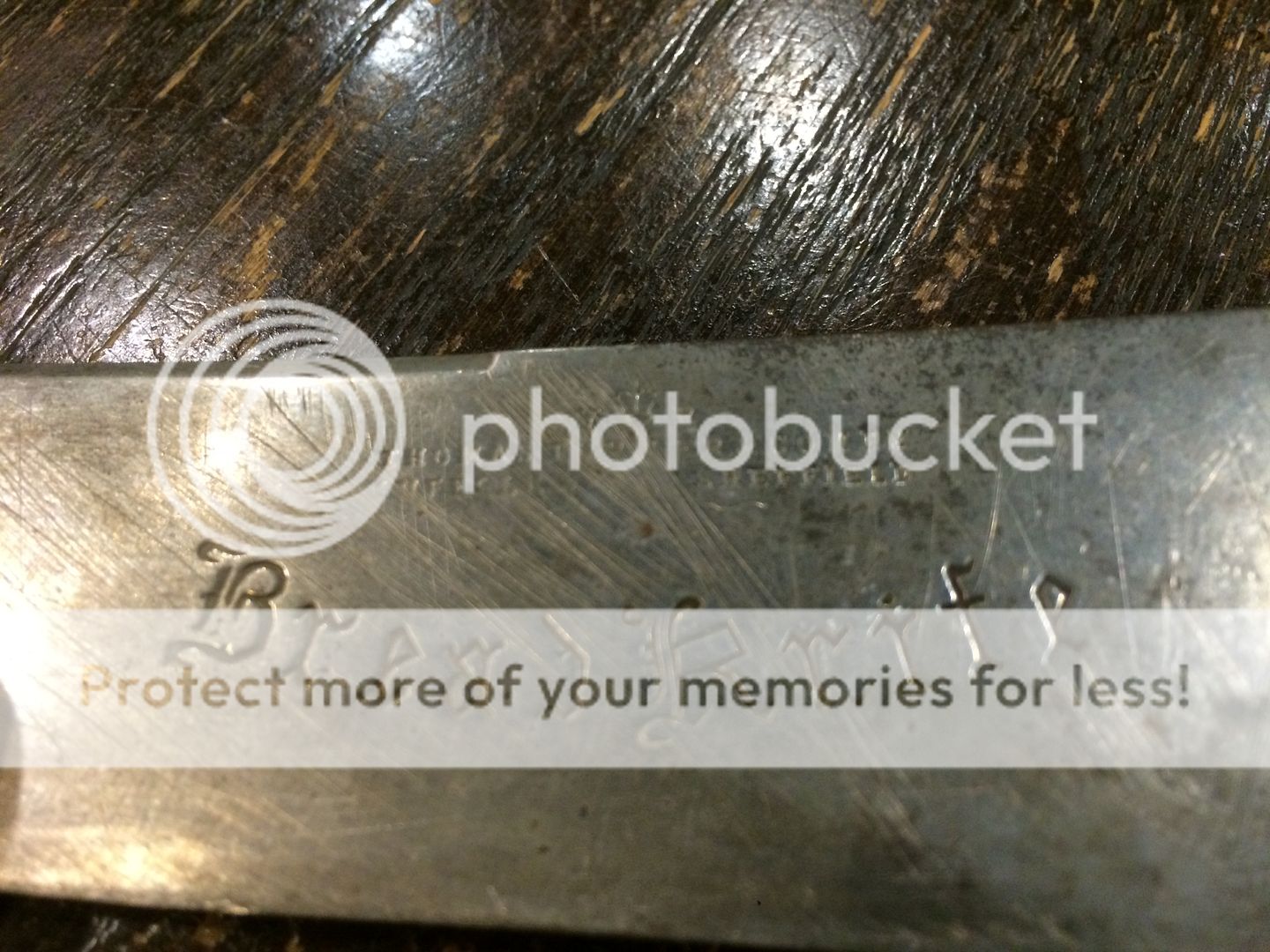

I have a customer that wants a bread knife. This is way outside my range. I don't know how or of I can even make one. Any ideas? I'm stuck.
basically its just a long blade with thin profile, and seratted all the way down the blade
I've read that back in the old days they used some kind of checkering file to put minute serrations on bread knives. Probably works better than the awful serrated things in most knife sets.
I was recently looking at the same thing, and it seems more complicated to sharpen the larger serrations. I was wondering if something like a back swept tooth would increase surface area but on a thinner blade, so much shallower. Kind of like the ones cut in this knife above....but way thinner steel of course. Curious if that would work, or just mutilate bread.

The serrations really aren't that hard to do with a round file, practice on a piece of scrap. I make them fairly regularly, but the people who will pay good money for a bread knife are pretty far apart.
I have never made a bread knife but I have sharpened a lot of chainsaws by hand. It's only a matter of a good file guide and practice to get consistent angles. You should be able to sort out a jig/guide to make it easier. It will probably take a while. ..

To make small close serrations-
Get a chain saw file in the desired size serration ( get several)
Get a brass rod the same size as the chain saw file.
Make the first serration with the file.
Tape the file to the brass rod at the top and bottom.
Place the brass rod in the first serration and file the second....place the brass rod in the third and file the fourth.....repeat.
After HT use a diamond file, a ceramic rod, or a rotary cylinder burr to clean up and sharpen the serrations.
Alternatives:
1) Have just a long thin blade with a 15-20° edge bevel.
2) Have large "scalloped" serrations along the edge. This is easier than it looks.
Make a long thin blade from 1/16" ( .060") stock. Taper it to an edge thickness about .020" ( no distal taper). BTW, this is a great application for the pre beveled 420 blade stock.
Put a small wheel on the grinder, say a 1" wheel. Mark the blade with a marker every 1" Make scallops in the edge at each line. This will make a blade with points every inch. ( you can make then closer with a 3/4" wheel and spacing) After HT use the same wheel and a 120 grit belt to make these scallops have an edge ( and make the points sharp). Hold the blade at about 15-20° to the small wheel so it grinds the scallop to give each scallop an edge bevel. This will also make each point sharp. Touch up with a 220 or 400 grit belt and you are done. Done right it will slay a loaf of bread or a wedding cake.
