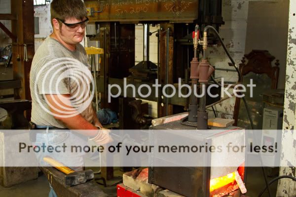

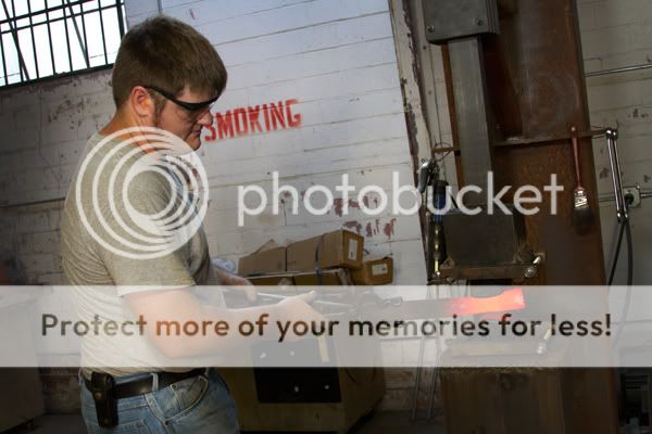

These were some progress shots taken by the photographer to whom I traded a bush sword (Paul Cruz). This isn't all of the process, of course, but it gives at least some idea of what's involved in making a bush sword.

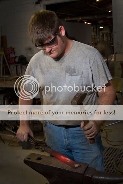

Processing the steel:

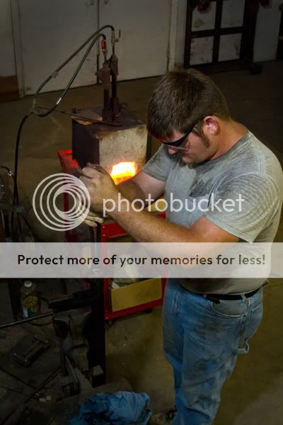

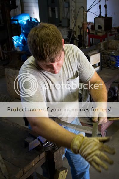

After all the forging is completed, the profile is finalized on a grinder, and the blade has the scale cleaned off, filing the primary bevel:

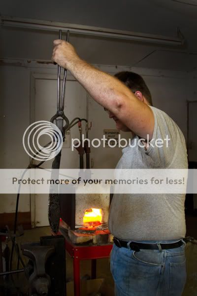

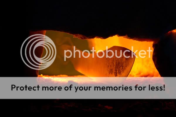

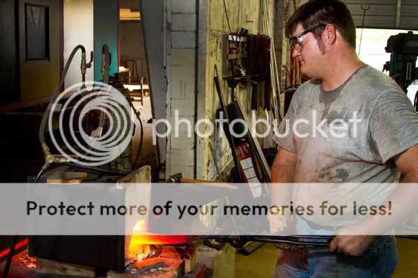

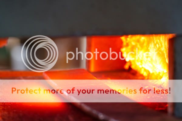

Heating the blade for the first quench:

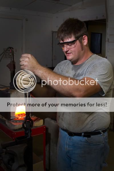

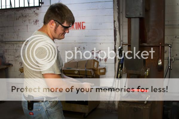

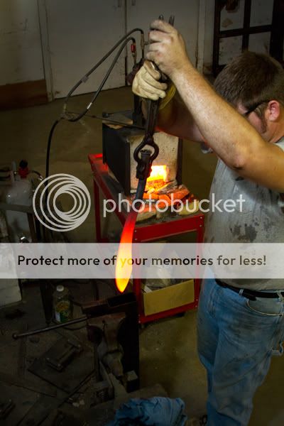

The first quench into veggie oil: Note that the camera isn't necessarily showing the color in the steel accurately.
Checking with a file to ensure that the blade hardened properly (it did):

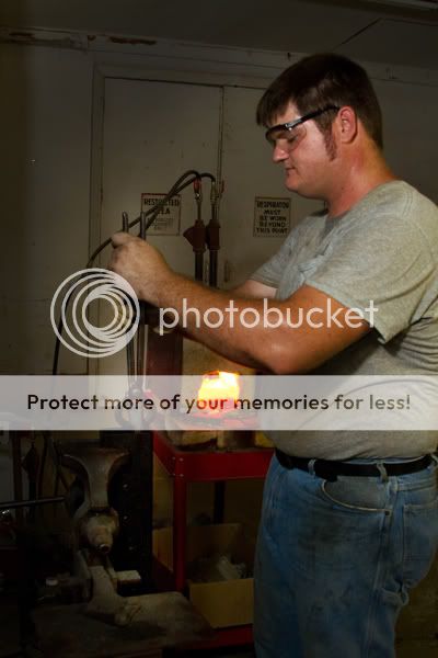

Time to do it again: This happens three times unless there is a warp that requires re-heating to fix.

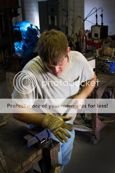

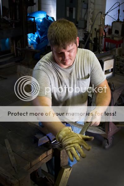

Many warps (and long blades are more prone to that than short blades) can be fixed without reheating if you work quickly and carefully. There is a short time window after the quench before the steel crystals fully set up, and during that time the blade can be flexed back straight. Here I am doing that using my post vise and my vertical quench tank to flex against:

You might get better quench results with a slightly bigger tank.

The tank extends down a little ways, so there's a decent amount of oil in there. I haven't had any problems with how it's hardening, though at some point I may make a longer one to handle longer blades.
