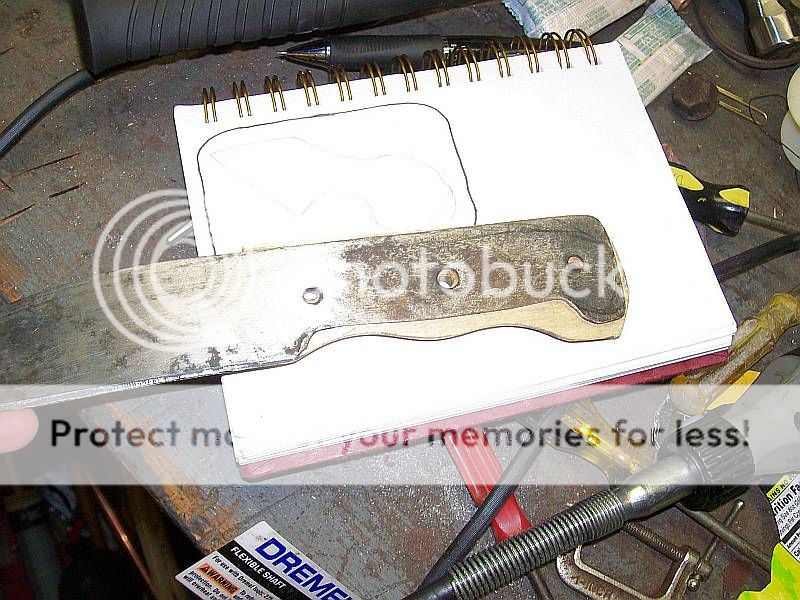

I have a cheap machete with broken wood handle scales. I decided to canibalize it.
Since the handle isn't that bad, i decide for my first knife to basicaly cut down the machete to a 1:1 blade/handle ratio.

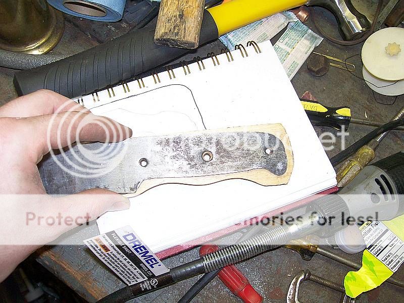

Here is my blade geometry, The straight lines i'll cut with the dremel. Then grind to the final curves.

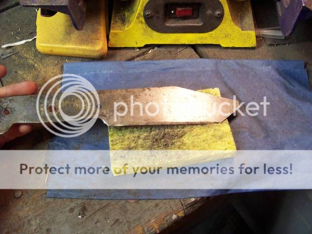

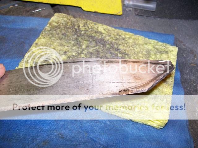

I press the metal into the wet sponge every few seconds to keep it cool. This creates an unexpected problem: the ink washes off.

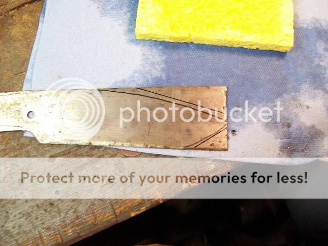

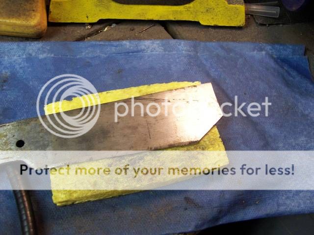

I scribe the straight lines and finish the cutting.
I redraw my curves and use an automatic center punch to create rows of dots that follow it as a grinding guide. Can't really see them here, but they helped.

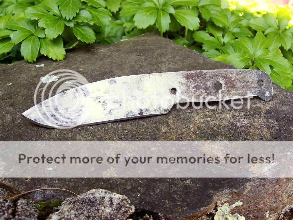

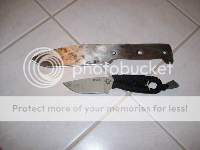

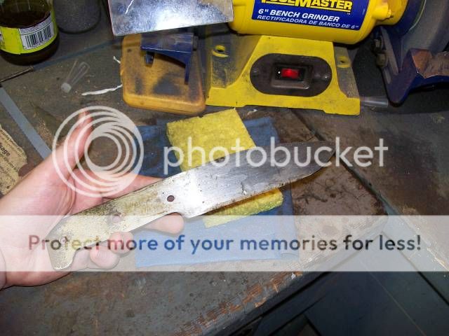

Here is is, far from finished, but the general shape and rough edge bevel angle are set. I've got about an hour and a half in it so far. Next to my Izula for size comparison.
What do you guys think so far?
(p.s. please don't move this to custom knives or something, I don't know anyone there. :p )
Looks great to me, good way to recycle some old steel. The only thing I might do it grind down that nub and the back of the handle. Looks like you even have enough steel left to do another.
looks awesome.
You may run into some issues if you are going to put scales on it... that first pin hole looks pretty close to where the edge starts.
Its going to be as soft as the machete was... should make a great field knife.

Yeh, really not sure what i'm going to do for a handle.
Some reshaping and a cord wrap would be simplest, especially with the slightly funky position of the holes.
Yeh, the steel is also flexible, which isn't nessasarily a bad thing, but it's one of the reasons I made the blade quite wide.

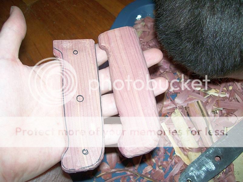

Here is the original handle and surviving handle scale from the machete. weird huh?
I thinned, smoothed and rounded the handle. Back with the old scale again for comparison

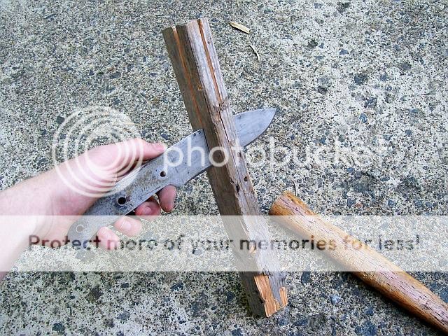

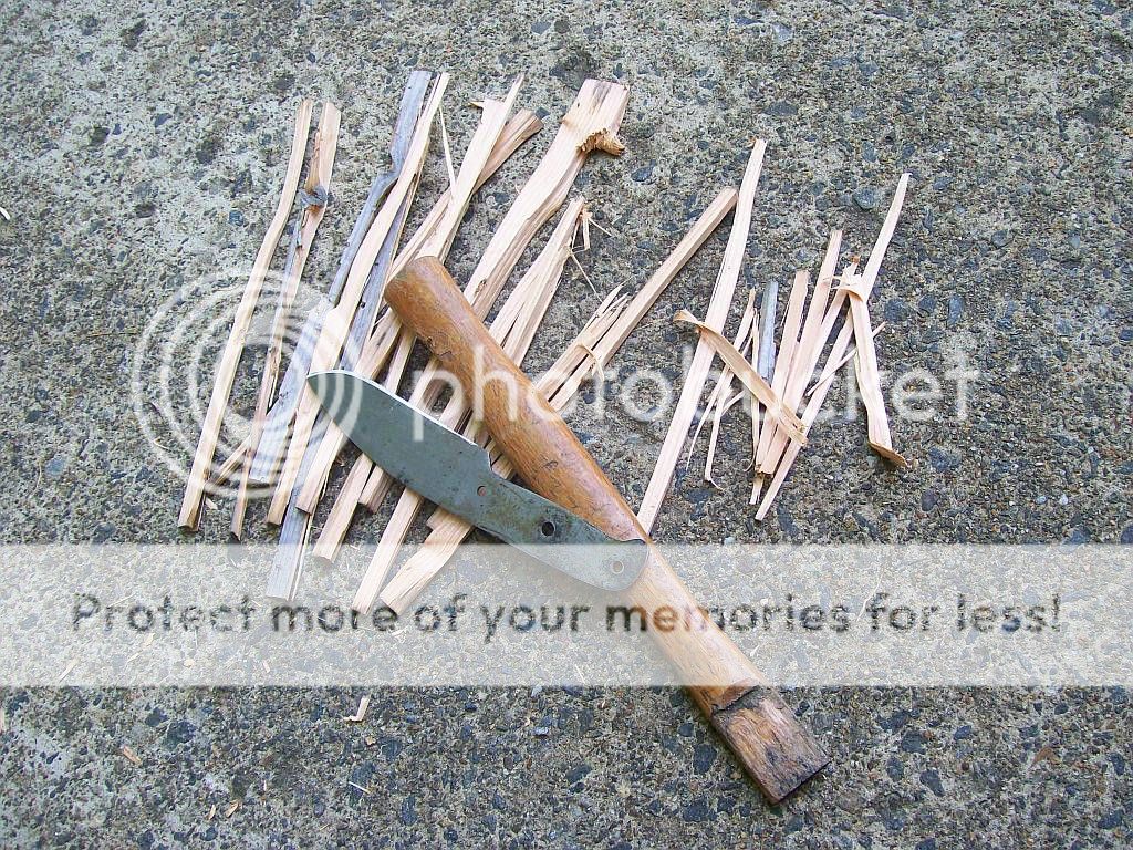

It batons nicely, I credit the humped back.

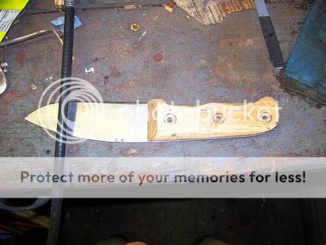

The Knife with it's prospective bride:
Hmmmmmmm, I think you just gave me a great idea on what to do with the saw-spine Ontario machete I have that I just don't like. Thanks!!
Handle scales! Carved with my Mora clipper. My hands ache...
These are going to get more shaping and be thinned down more.
But it's gonna look something like this.
My young compatriot thinks fresh cedar chips smell great.
